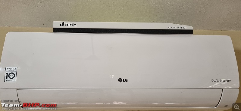

2024 Feb : The LG AC is not cooling well. LG diagnostic app says the AC is only drawing in 300 watts of power even in the most powerful setting. I call the LG service team and they pressure wash the IDU and it cools better and works ok for a couple of months.
2024 May : Cooling is bad again. I call the LG service guys again, and this time they dismantle the IDU and give it a more thorough wash. Cooling is better but even then its only drawing in a max of 750 watts even at turbo mode.
The max rated power consumption is 938 watts
2025 Feb : The AC is only drawing in 250-350 watts. LG guys are called again, they dismantle the IDU and pressure wash both the IDU and ODU. But even after the wash, its only working at <600 watts. I report the issue again and they are clueless and insists there is nothing wrong with the sensors.
Originally Posted by revintup View Post
UPDATE
I had raised another complaint with LG and they have agreed to dismantle the IDU, and take it to their shop to give it another wash using an even more powerful machine. All these installing and uninstalling is making me a bit uneasy. Already some of the fins have been bent.
They are not charging me anything so why not? Fingers crossed.
UPDATE
LG dismantled the AC again, and took both the IDU & ODU to their service centre. They said they will clean it more thoroughly using some chemicals and a washer which works at a higher pressure. They kept the AC for 2 days and reinstalled it on Saturday. The cooling is back to normal. Its working at almost 900 watts (in turbo mode) now. So yes, am happy with the results.
In the end I think that the LG AC is highly sensitive to dust clogging, this could be due to some inherent design issues.
I have ordered an 'Airth' external air filter on Amazon in the hope that it will reduce the dust getting into the AC. This is mounted on top of the AC. Yes, this might 'choke' the AC, reduce the airflow and cooling but I would rather have reduced cooling due to restricted airflow than clogged interiors which would mandate dismantling every year.
First impressions of Airth air purifier.
The packaging is excellent and the product feels well built. The filter just needs to be seated on top of the IDU and that is pretty much it. Its designed to be smaller than the air intake area on top so that airflow is not hindered significantly.
As I have mentioned in my previous posts, dust clogging reduces airflow, and the AC powers down significantly. However I see absolutely no impact on performance due to Airth. But of course, the filter is brand new and clean; once the external filter starts accumulating dust, performance might take a hit. The brand advices vacuum cleaning the filter every 3 months and replacement every year.
I am planning to clean the inbuilt filter every 2 weeks and water wash the AC every 6 months.
NB : I do not have an AQI monitor and so have no idea if this is purifying the air.
Recently saw this product when the founders came on one of the Shark Tank India episodes.
Do let us know how efficient the product turns out to be; I am definitely interested in this one if this helps even to some minimum extent.
