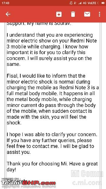

Originally Posted by thoma (Post 4081683)
Since the item was out of stock for a replacement, the phone was returned for a refund which I am still awaiting.
So, in the mean time I bought the same item afresh as I liked and needed a Xiaomi RN3, alas forfeiting offers from the earlier purchase. The new piece arrived today and to my surprise, the same issue of mild electric shock from the back panel while charging is present with the new phone too. I took it to the service center and though they didn't check it physically as it was outside office hours, they said that there should not be the slightest of shock whatever be and added that I should return this too.
I tried charging the phone using another charger, another socket and another residence; still the issue persists. But I have to add that the issue is absent when the phone is being charged from the power bank.
I have no clue whatsoever.
Can anyone using the Redmi Note 3 confirm this? One of my friend who is using it denied the same on his phone, but the second time I asked him to observe a bit more carefully by lightly moving his fingers across the back panel, he got the electric tingling.
Is it true that every metal body phone gives some electric shock while being charged? I came across this info where someone else was feeling the same. But the advice is contradictory to what the local Xiaomi service center guys told.
Attachment 1570632
This got me interested. The charging voltage of a mobile is 5V normal and up to 12V Fast charging. At these voltages the resistance of body under dry conditions is very high. But the resistance can vary widely from person to person. For human beings to perceive the current it should be more than 1mA. Not many people can sense the current at such low voltages even if you hold the two terminals together. May be you are more perceptive to electric current. Any of your family members could feel the same? I don't trust the bunkums provided by service guy.
Since you tried another charger at another place, it may be an issue unlikely with ground isolation. Most of the low cost chargers won't have AC/DC ground isolation. So any stray voltages from the supply ground fan find path to earth through your body.
Not on a phone specifically, but I'm used to feeling slight electric currents in situations where almost nobody else can feel anything.
A few years ago, I actually replaced my newly-bought Samsung TV twice because I felt a slight shock on the back panel ports (which nobody else, family or installation technicians) could replicate. Thorough and patient testing of all electricals yielded nothing. They finally politely asked me to consider claiming a refund because there was no real solution to my 'problem'. I let it be, and I chalk all this upto being overly sensitive to electricity.
P.S. This only applies to barely perceptible current, and doesn't mean one should simply and broadly overlook all possible electrical faults. Get stuff tested by a competent electrician and if nothing turns up, let it be if it's not disruptive.
I had tested my phone with 3 others too for confirmation. Interestingly, as I said earlier, one of my friend who owns a Redmi Note 3 first denied the issue but tried a second time more carefully on my request and he too confirms the same current/whatever.
But the most interesting thing is that the shock is not present while I charge using my power bank. And if the power bank is plugged in for charging, again the shock is felt. Any electronics gurus here?
Meanwhile I came across another piece of info about using capacitors to prevent radio interference, though I didn't understand a bit:
Some AC-powered devices, presumably like those chargers, that don't have a ground prong use capacitors between the line/neutral and the metal parts of the case to prevent radio interference, etc. This can provide a path for a small current to flow from the line into the case so that you can feel a bit of a tingle when you make contact with them and a grounded surface. My guess is that the Nextech charger allows a bit more current to flow than the Asus one, but it's likely not dangerous in any case.
P.S: Surprisingly, today, the Mi community thread which had the screenshot of Xiaomi customer care's reply (the one I posted above) is taken down / under moderation.
Not only phones, but I have noticed this behavior on all gadgets with a metal body. I can confirm the case with all iPhones in family and my Macbook too.
With regards to your macbook, make sure that you use the proper 3-pin cable with earthing. It will increase the durability of the device as well.
