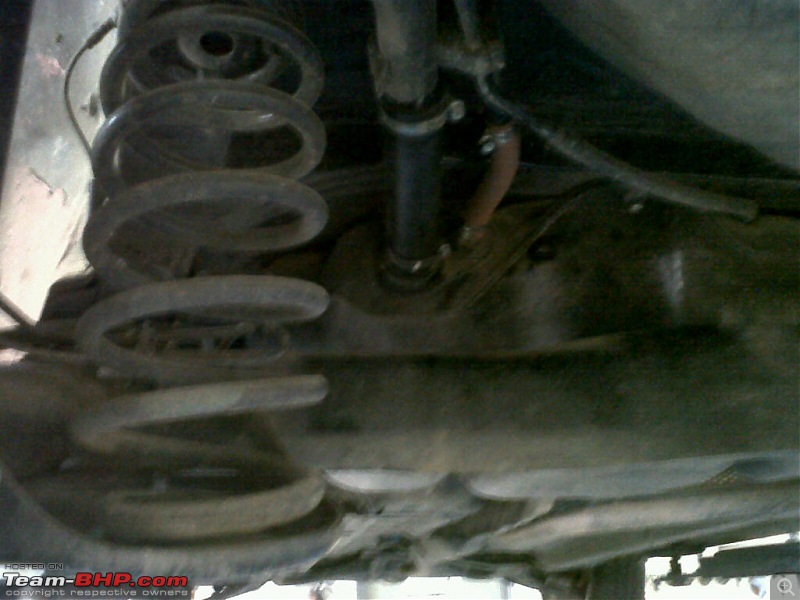

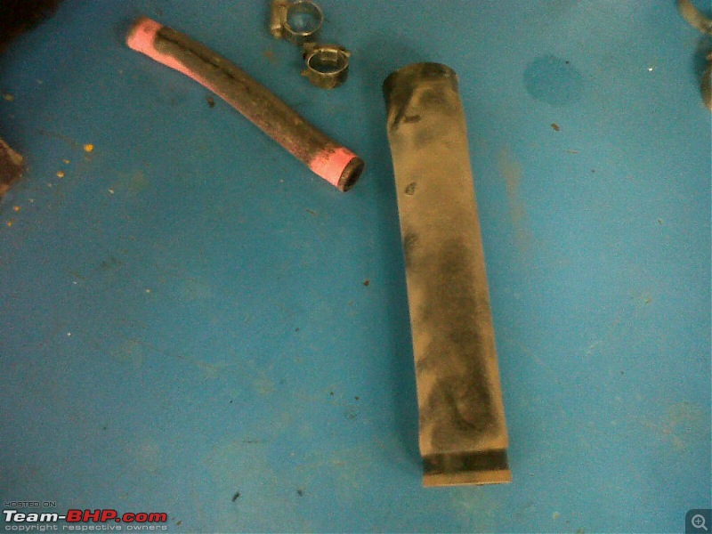

I own a march 2011 12k run Etios (P)
I saw the recall message on facebook fan page of Etios 2 days back. Immediately called my SA who said i can come anytime to get the free replacement done.
Called the SA today morning at 9. Reached workshop at 9.15. Met the SA. He immediately created the job card and took the car to the shop floor. I requested to be on the shop floor and he agreed immediately. I was on the shopfloor for the entire duration.
The service mechanic connected the car ECU to the hand-held. Disconnected the engine fuel supply and drained the fuel via a touch of a button on the hand held. Neat. Petrol quantity was showed to me.
Then the car was raised and the fuel pipe connecting the fuel inlet and fuel tank was replaced.I had alook at the old part and it didnt show any cuts or bruises. The service mechanic said that out of 1000 cars coming to DSK toyota only 1 had shown a bit bruises. Anyways toyota is replacing them free of cost for all the cars.
Then the car was taken to a complementary wash and cleaning.
Total time in the workshop 1.5 hrs. Total cost 0
I had a detailed chat with 'Etios master' and he said it is a minor problem and seen in just 1 car. He mentioned that TKM is working on NVH levels and interiors of Etios and a refresh edition may come out in next 6 months. I talked to the service manager and he said that whatever can be retrofitted to older cars like mine would be done.
I highly recommend my SA Vishal and flawless service of DSK Toyota.

Toyota ETIOS Recall - Aberration in the filter hose.-img00039201112240951.jpg
Toyota ETIOS Recall - Aberration in the filter hose.-img00049201112241023.jpg
Toyota ETIOS Recall - Aberration in the filter hose.-img00050201112241023.jpg
Toyota ETIOS Recall - Aberration in the filter hose.-img00045201112241018.jpg
Check out the pics
