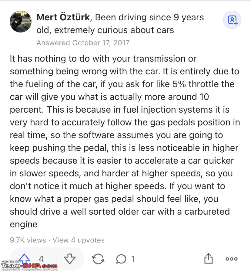

My car has run about 960kms now in the last 20 days, I’ve been noticing a slight jerk when I’m in second gear, and I’m not sure what is causing it. Here are some details:
1. I usually shift to second gear when at around 15 kmph. I continue in second gear till about 25kmph or sometimes 30kmph.
2. Since the car is still new, I’m going very easy on the accelerator pedal, and I press it only very lightly. This means that the car is usually in the second gear for about 3 seconds.
3. Almost every time, after 2 seconds, I notice a jerk in second gear. The jerk happens only once, and can be felt for a fraction of a second.
4. It feels like the fuel supply is cut off for a millisecond, and comes back. I don’t think (rather don’t know) this is what is happening, but it sure feels like it.
5. I showed this to the service advisor during my first service, and he said it is normal with most petrol cars! It didn’t sound right, but I’ve driven only diesel before, so I don’t know for sure.
6. The service advisor said that they also reset the ECU just to make sure, but it doesn’t seem like it made a difference.
Can anyone please tell me what this could be?
Is the service advisor right about this being a normal thing?
My car is VX MT Petrol.

The service advisor is most likely faffing around. We've had 4 petrol cars in our house, 2 being manual and have never experienced or heard of in-gear jerking being a common thing in petrol cars. However, it might not be a real issue, as you mentioned you've been taking it lightly on the throttle, some engines do cut off without "adequate" pressure as they might be tuned for fuel efficiency. You could try driving around with a little more pressure on the accelerator while in second/ while shifting gears. The run-in only applies for flooring the pedal and revving the engine out. Avoid that but you don't need to be extra careful just because the car is new. I would suggest driving as you would your previous car.
However, if the jerking still continues you should push for a proper check from the ASS.

nTorq, I also have noticed these minor jerks in 1st and 2nd gears. I too drive with a very light foot on the accelerator. The SA told me not to worry and keep steady acceleration to avoid these jerks. The key is, only I (the driver) feels this. Nobody else in the car feels this. So I guess there is nothing to worry. Mine is a ZX petrol and has run around 3.2K KMs.
You’re right about only the driver feeling it. I will try driving it with a little more force on the pedal. Will update.
Also, I was searching online, and came across an answer on Quora that seems like a logical explanation. Please see the attached screenshot.

Had this issue in my Ford Endeavour 2010 model. Only difference being that it used to happen in any gear. The issue was with fuel injector which is electronically controlled based on RPM. After changing the injector, the problem got solved. It costed me 45K in 2017.
