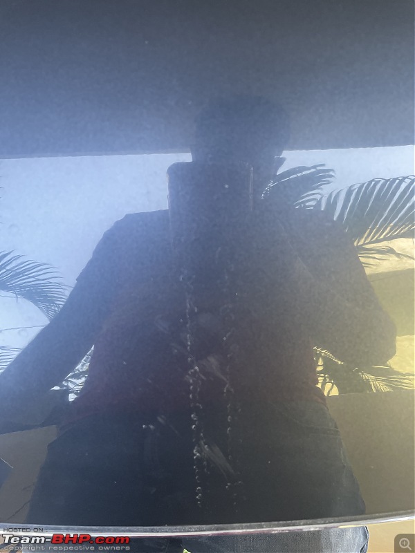

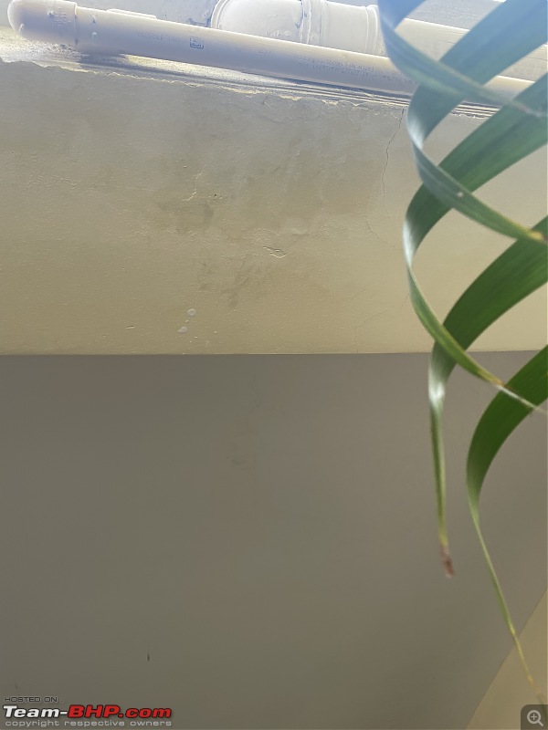

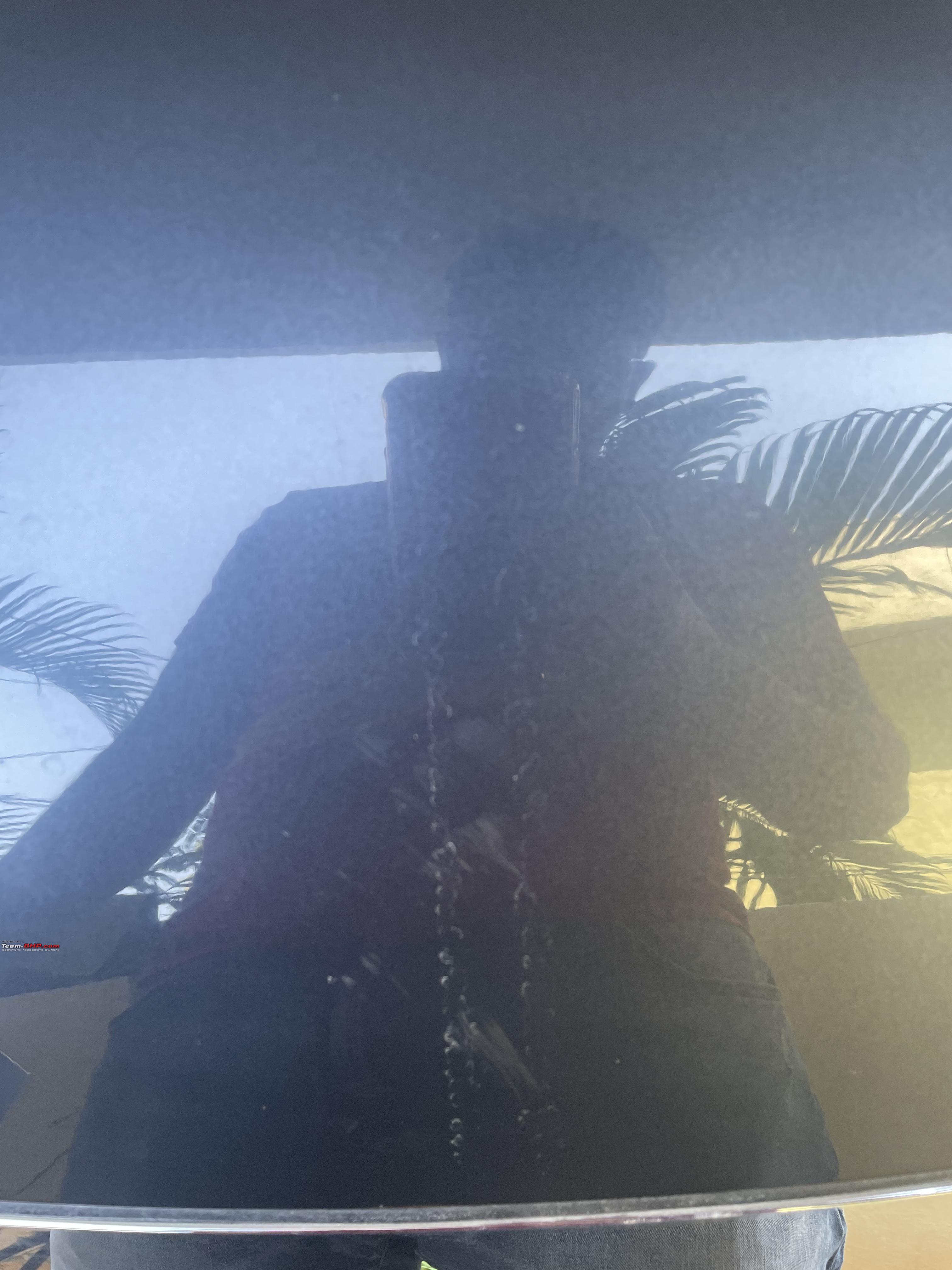

I had parked car in basement and the leaky ceiling caused multiple white spots on the bonnet of grey colour honda city. It was looking horrible, i had recently done ceramic coat though it didn’t help to prevent it much.
Tried multiple ways
Tried washing with shampoo - no use
Tried traditional lemon method - 2 lemons wasted and slightly it reduced
Finally read about it and researched online found it to be calcium carbonate or some alkaline deposit which will go with acid( so lemon helps as its citric acid)
Finally my own DIY - used lysol as we use it for bathroom scaling and it worked like charm. Sorry didn’t click post effect photo as I already had wasted 1 hour of my Sunday on this mark but it has reduced almost 90%. Mostly one car wash with polishing will do the final job.
