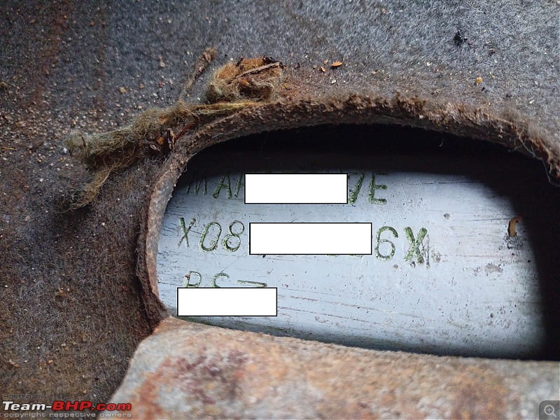

The other formalities for renewal of registration would be completed, and I had to present the vehicle to the RTO after engraving the Chassis number for the renewed RC to be issued. I went back to the agent's office and he asked me to try and get the re-engraving done by the time the permission letter was issued from the RTO. Almost all processes related to the registration of vehicles are done online in Kerala now. But the issuance of such permissions had to be done manually, from what I understood from him.
I spoke to a mechanic who is known to me, and he was reluctant to do the work without the permission letter from the RTO. I decided not to push him too far and wait for the letter to arrive. However, after almost a month of waiting, the agent called me and informed me that he had managed to get the AMVI to report that the re-engraving was done and now, the RC would be issued! Probably the officials also did not want the trouble of manually issuing the permission letter and later doing another round of paper work after I present the vehicle for another round of inspection.
Later on, I received the renewed RC by registered post and then took the car to the local mechanic who was now happy to do the engraving. I got the work done and informed the agent as well.
Re-issuance of rusted / damaged chassis number : The process & my experience-working-teambhp.jpg
Not the best of work, but acceptable, I guess
