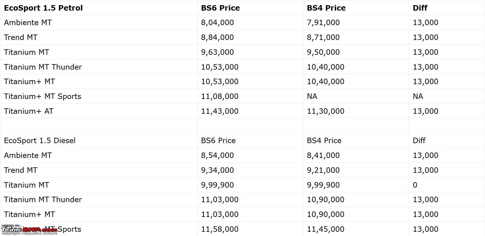

Originally Posted by sukarsan View Post
Looking at the issue coming 1 year after launch I can be sure that some cost optimization exercise under pressure has gone terribly wrong.
Awesome post, thanks.
Cost optimisation indeed - you nailed it. The EcoSport Diesel BS6 cost merely 13000 bucks more than the BS4 version!
Ford India struggles with DPF problems in 1.5L TDCI | Poorly handled & utter lack of transparency-test.jpg
Source (Ford EcoSport BS6 launched at Rs 8.04 lakh)
