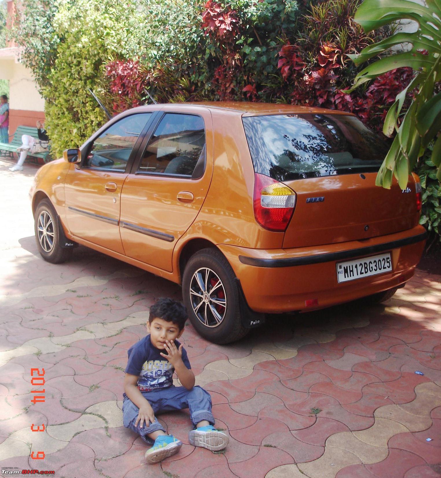

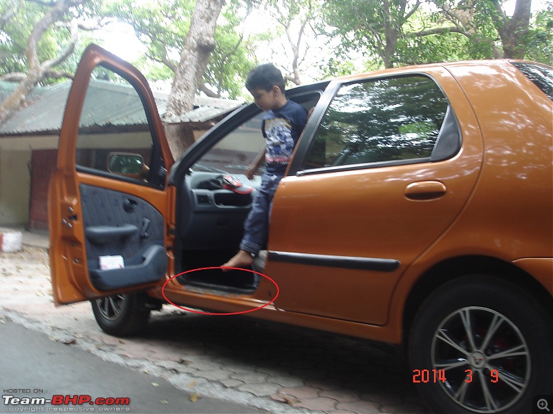

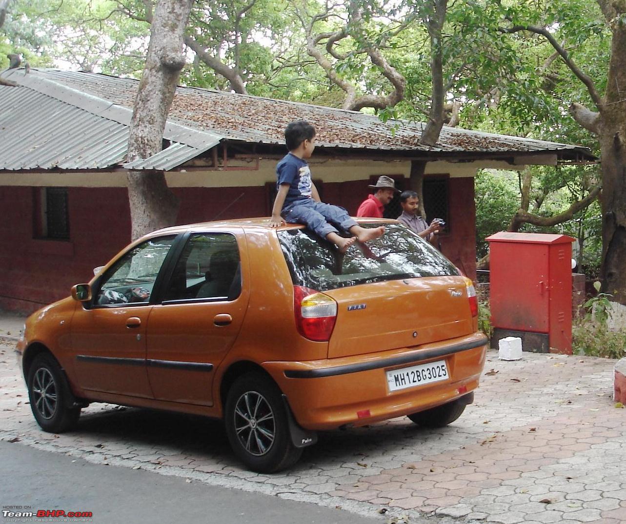

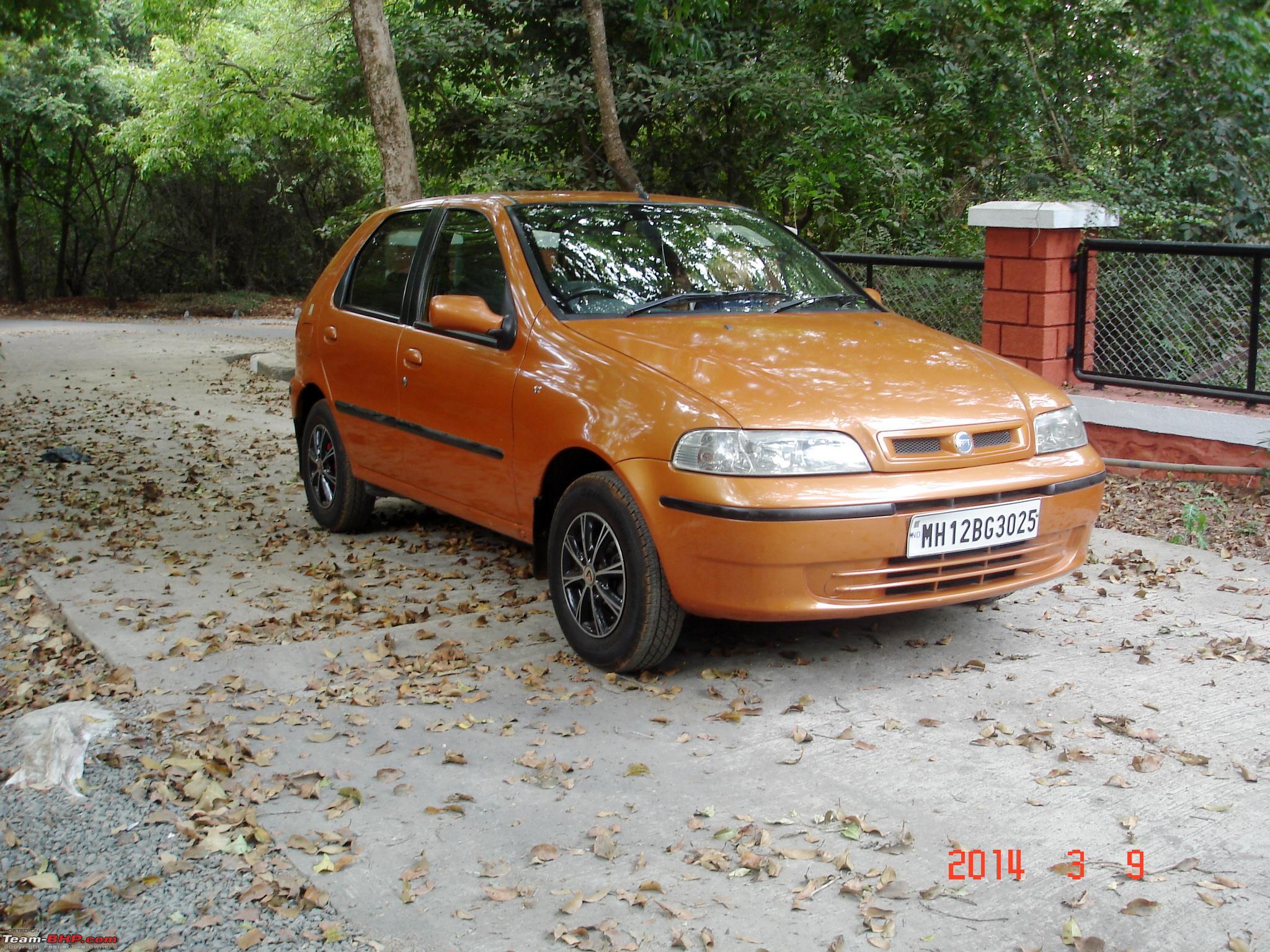

Hi friends,
Its been great reading reviews for Palio but bad on my side that I did'nt post anything regarding my Palio. Firstly, I would like to thank Vipul to start this thread for Palio. Taking time to maintining a car itself is an activity where you never know how time flies off. But penning down regularly with every detail update of the things he did to maintain the beauty is awsome. You have done a great job maintaining a Palio.
Your thread has impressed me to share my experience with my Palio.
I own a 2002 Palio EL!
Yes EL -WPS-WPW - Meaning without Power Steering and Power windows. Its a basic piece of metal but with a class of driving mannerism.
This is my self owned first car though a second hand. Previously I used my dad's Premier Padmini, Amby, 118NE & Dodge Kingsway(Dad's gift) then Indigo and finally a Santro. I have driven many more cars manufactured in India but somehow i was not satisfied and each time i saw a Palio, my desire to own one increased. I remember during my study days I got an opportunity to drive one of the first few 1.6GTX(Tangereine Mist) of my relative staying in Bombay. The drive so stuck in my nerves that whenever I drove some other car, I started to compare it with a Palio. Later when I started earning, I always had in my mind that one day i will for sure own one but due to FIAT aftersales issues I postponed the ownership.
Finally in 2009 I purchased a Palio after a long hunt. It was an expensive deal of 1L but worth considering the ingenuity of the car.
The car was very basic and the body paint looked dull but the body line spoke about the care the previous owner took. During the purchase it had 62K on the odo. I drove it for 6 months before giving it a coat of paint. Now it's 4 yrs of paint but still has the gloss. Got the dark film peeled off to fit a lighter green Lunar and gave the B-Pillars a mat finish to have a masculine look. I did search for alloys and side skirts but could not find a suitable. Finally, last year I figured out a set of Aura and fitted with the stock size tyres. I love to have my vehicles in clean and stock condition.
Few of the readers may find this strange but it still has the blue plastics at the front door rubber seals.
I am attaching few of the pics of which 2-3 are before paint job. The latest ones have Alloy's fitted. Will upload few more later with more details in my writeup as to what issues i faced with the Fiat/TATA service centers..
Now the odo reads as 99750kms.
