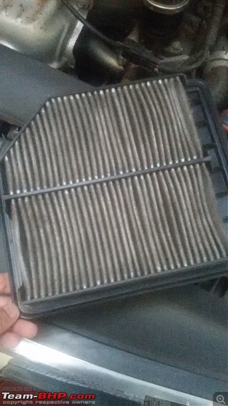

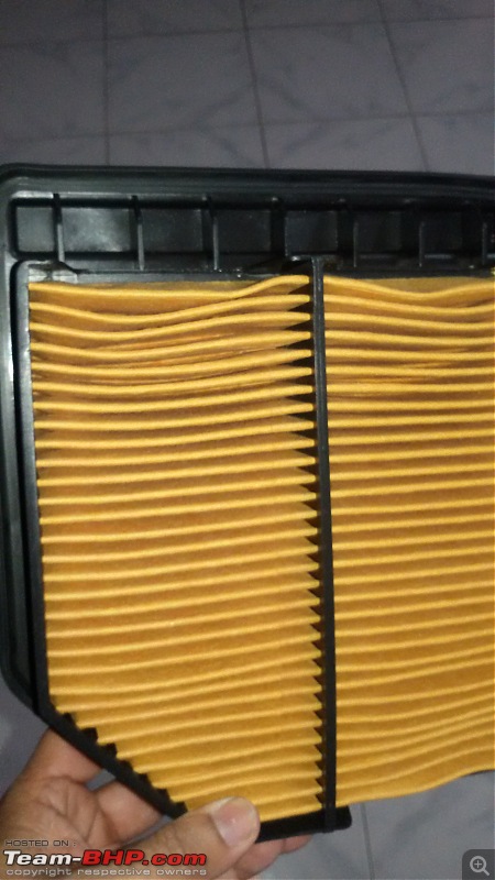

I have replaced the air filter with a Sakura make for 450 bucks. Pai auto had charged 495 bucks for same when i had got a Sakura from them. Got this one from another shop. Below are pics of the old air filter and the new one. I had done around 12K kms on the old air filter and thought it was high time that i changed the filter.

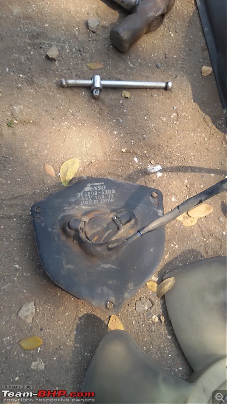

I had gone to Suraj Auto for a general tune up and checking. On the return trip home i found the temp gauge going beyond the normal mark. I switched off the a/c and cng and found the temp gauge moving down to it's normal position. When i came home i popped open the bonnet and switched on the a/c. Just as i had suspected i found the a/c condenser fan was not switching on.
I called up Honda and asked how much a a/c condenser fan would cost. They quoted a astronomical mind numbing 12K for same. I then decided to show it to a local a/c garage guy who first checked the relay for issues and diagnosed a fan failure. He quoted 3.2K for a original denso and around 1800 for a non original make. I decided to go with the original denso for 3.2k + 100 buck labour. So that's another 3.3 k drain on my wallet.
Below are some pics.
Honda Civic Independence : CNG'd. EDIT: 1,13,000 km up and SOLD!-20150214_143559.jpg
Honda Civic Independence : CNG'd. EDIT: 1,13,000 km up and SOLD!-20150214_143552.jpg
The old fan motor. I forgot to take pics of the new one.
