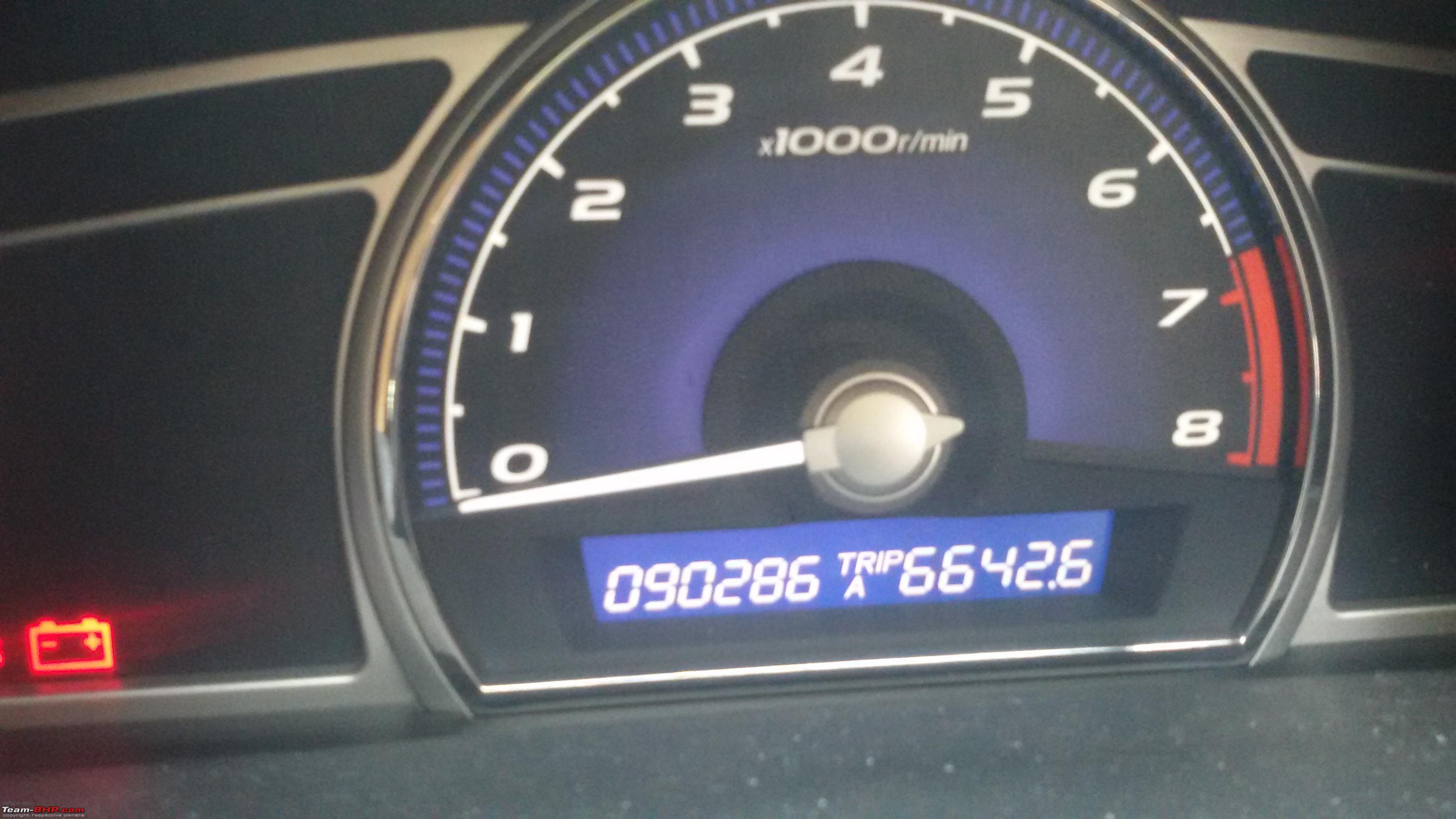

Odo has turned post 90k. Nothing much to update except had given car for 80k service and got a fat bill of 10.6k courtesy the fuel filter. Honda service reminder personnel keep nagging for service due calls so have blocked their nos on my phone. Will unblock them after 6 months when the next service is due. 3 months service interval is too soon than required especially for a out of warranty car.
In the bill you can see Honda personnel have listed out faults etc all of which are not needed to be done except for rear pads which are down to 4mm. They even listed the lower arm joints and bushes as local even though i had changed them from Honda itself which proves they are just doing a cut paste job of things to be done from the old service history.

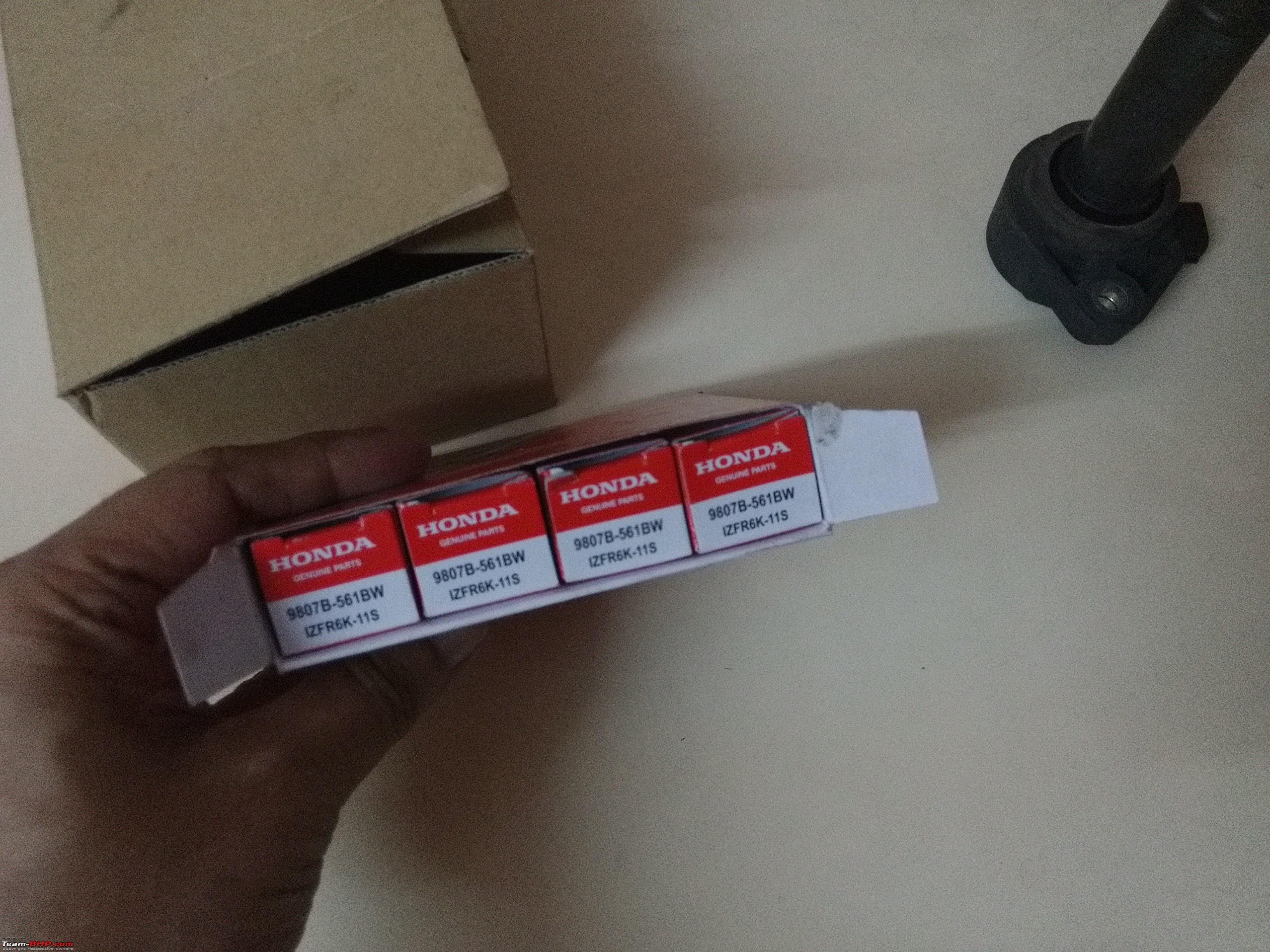

The spark plugs came at 1023 a piece.
Honda Civic Independence : CNG'd. EDIT: 1,13,000 km up and SOLD!-plug_box0.jpg
Honda Civic Independence : CNG'd. EDIT: 1,13,000 km up and SOLD!-plug_box1.jpg
Honda Civic Independence : CNG'd. EDIT: 1,13,000 km up and SOLD!-plug_box2.jpg
Honda Civic Independence : CNG'd. EDIT: 1,13,000 km up and SOLD!-plug_all_box.jpg

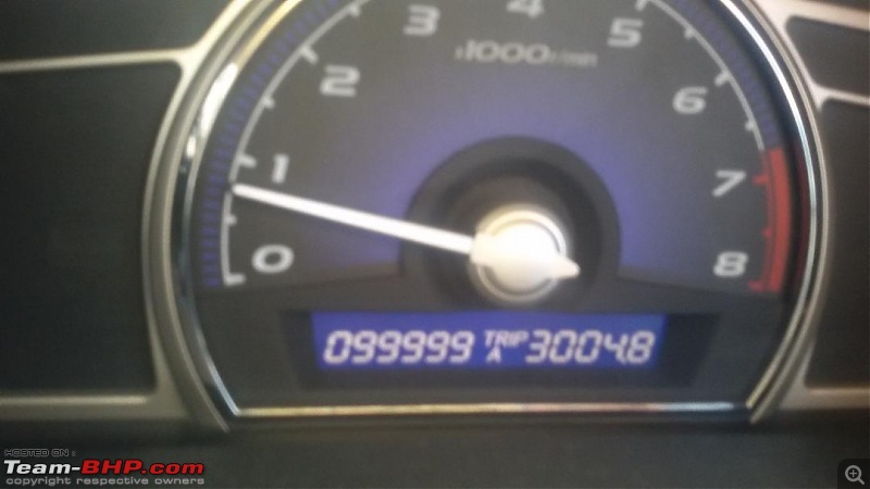

The ODO reached closer to the 100k km mark sooner than I expected.
Honda Civic Independence : CNG'd. EDIT: 1,13,000 km up and SOLD!-20170815_081032.jpg
