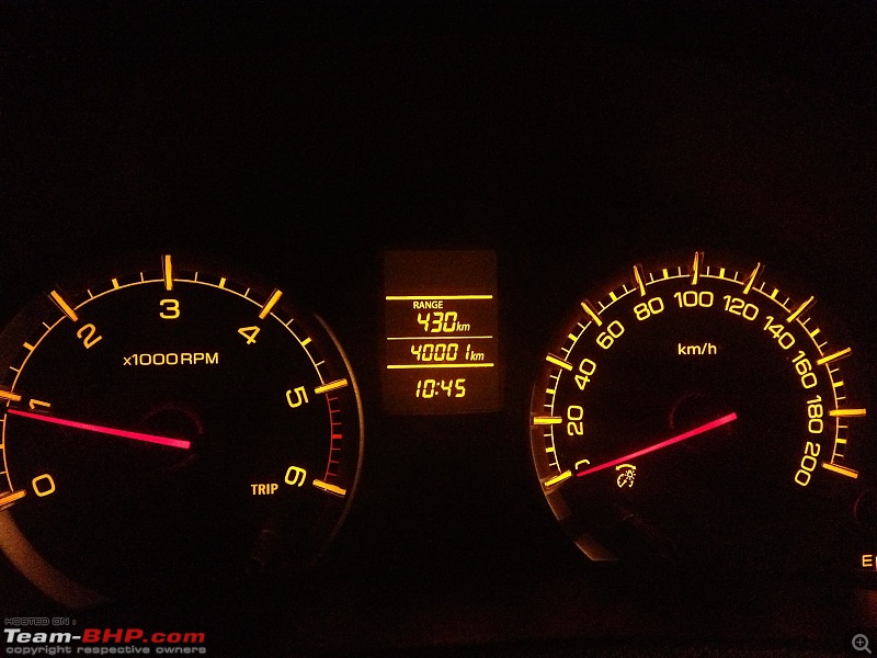

The car went past 40,000 kms on 4May'13. 3,800 kms out of the last 5,000 have been clocked while driving across South India. Most of it on highways and the coastal belt of India from Kanyakumari to Goa. To say that I had a blast would be an understatement. The car lived up to its testimony of being a very reliable, fuel efficient and fun to drive product. Just the right blend to appeal to an Indian mindset.
My Gen3 Maruti Suzuki Swift VDi Sep2011 1,05,000km done EDIT: SOLD-img_1301.jpg

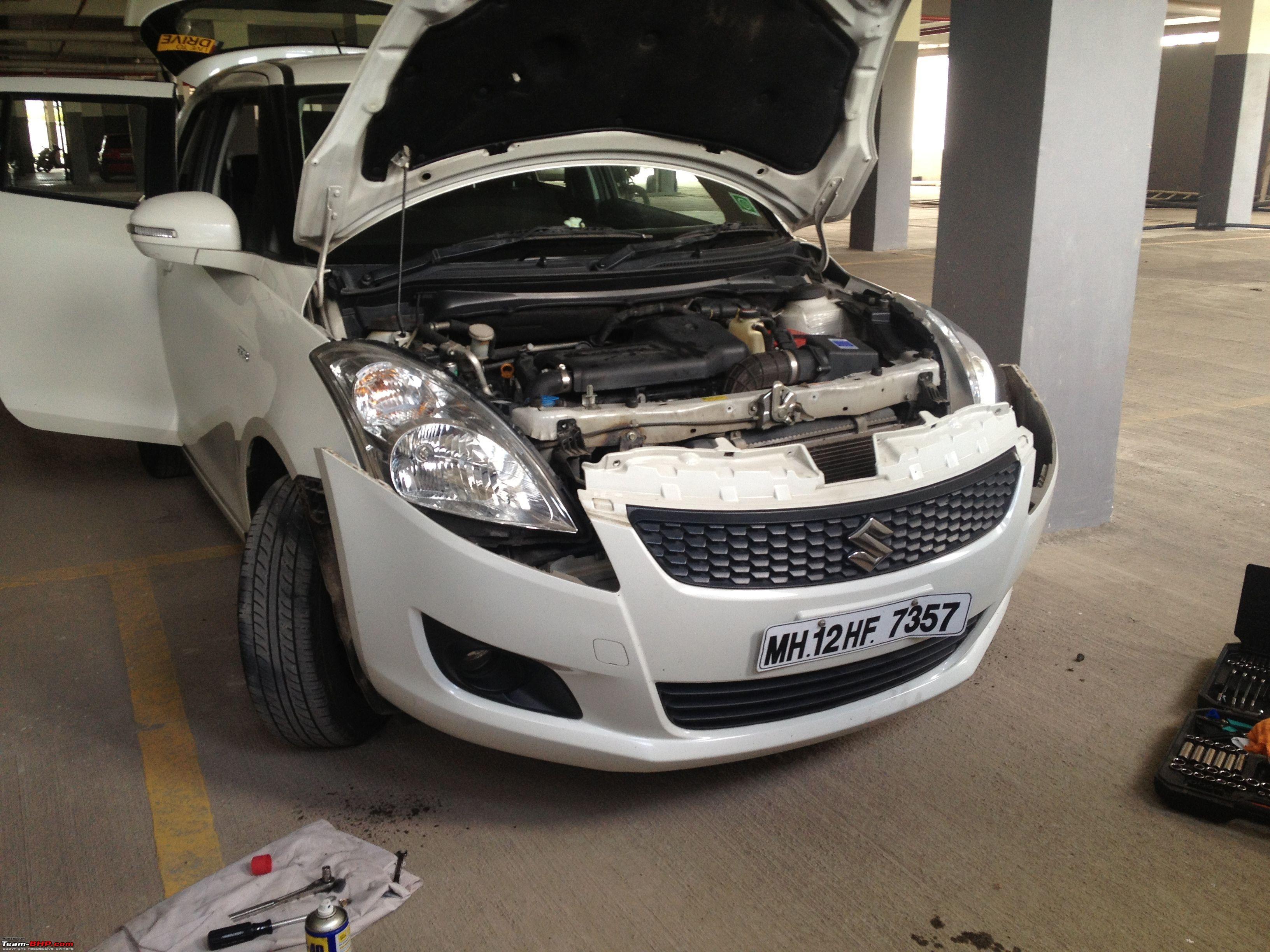

At 40,000 kms, it was time for a routine 5,000 km service. There were some issues that were bothering me. There was some noise from the underbelly while driving over rough roads. I had presumed that the front suspension was shot. The brakes were not so great and were squeaking. Oil levels were fine but I had done some hard driving while on my trip. Booked a service appointment with Sai Service and landed up at the workshop at 7:00 am. As usual, I was the second customer to be there. Requested the service advisor for a quick service as I was going to hang around in the workshop till the car was ready. Problems reported:
Noise from the front underside:

Additionally, requested a replacement of gear box oil, coolant top up, brake oil top up and general checkup of the car.
Much to my dismay, the car stood there waiting in queue behind other cars that turned up much after me. Saw a couple of email addresses in the customer service lounge. Pradeep Bhonsale is the workshop manager and he seems to have quickly responded to what was an email expressing displeasure over the way cars are handled for priority. He sent his deputy over and the car was taken into the service bay. The mechanic working on the car was a thorough professional and did all the jobs with great detail.
The underside of the engine has two plastic panels for protection that are held together by clips. My experience with these has been terrible. This was the 4th time they had given away. The mech went out of his way and fixed the panel using 10mm bolts and nuts as a permanent solution. I was impressed to say the least. This may be the last time I have to worry about noise from the underside and rightly so! It's been 3,000 kms since last service and I haven't heard any noise from down below:

Oil leak was traced to the sump. It seems the sump bolts were loose. Went under the car and noticed that my car's engine was assembled by Fiat Powertrain . Tightened the bolts and sprayed petrol to clean up the oil residue. We tested the fix by keeping the engine running for 15-20 mins and saw no oil.

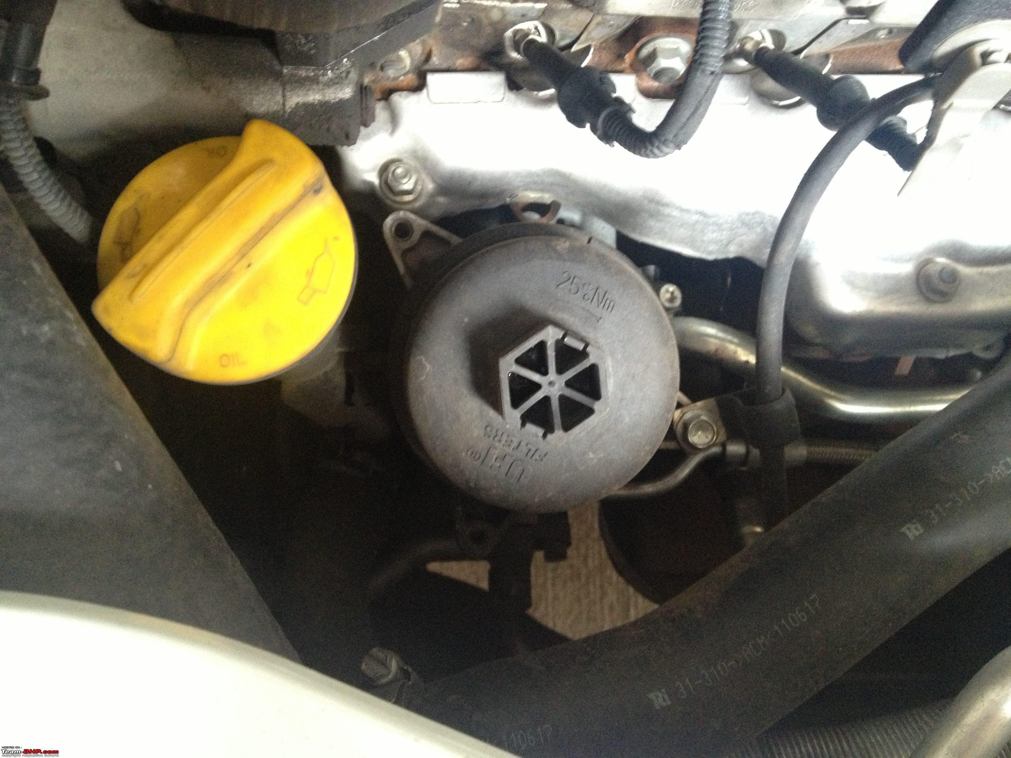

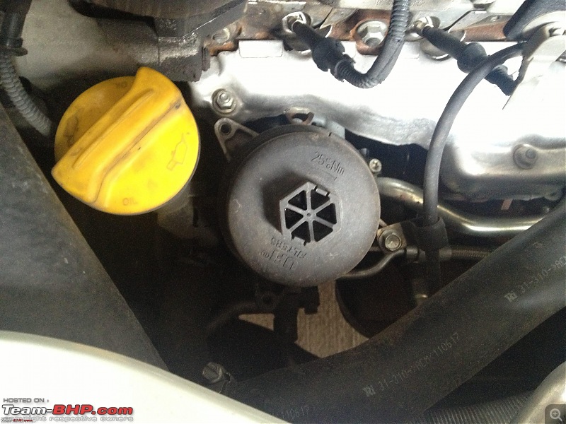

See the belt? It has FPT marked on it. FPT is Fiat Powertrain.
I thought that FPT stands for Fenner power transmission. Fenner manufactures drive belts.
IIRC, there is a mark near the diesel HP pump side which indicates if the engine was manufactured by Fiat powertrain or suzuki powertrain.
Check the logo on the belt and compare it with this one

Got the car pressure washed at Sagar Auto care
Drove back home and collected all tools. Meanwhile the engine cooled down a bit. I am sucker for use of safety gear so, out came my Mechanix gloves I had picked up from the states. They not only help in saving your hands from cuts and bruises but they also aid in providing sufficient grip while using your tools. My Craftsman tool kit is quite useful for carrying out odd jobs as these. The 27mm bit was an add on purchase since I didn't have one. A plastic tub to drain out oil and a measuring jar for refilling oil were other purchases I made.

A click of the odo at 45,000 kms. (The car has crossed 55,000 kms as on date):

The hose above the oil filter cap has been rearranged in the new Swift vis-a-vis the old one see this
My Gen3 Maruti Suzuki Swift VDi Sep2011 1,05,000km done EDIT: SOLD-img_1925.jpg

Wrench on the oil filter cap:
My Gen3 Maruti Suzuki Swift VDi Sep2011 1,05,000km done EDIT: SOLD-img_1929.jpg
