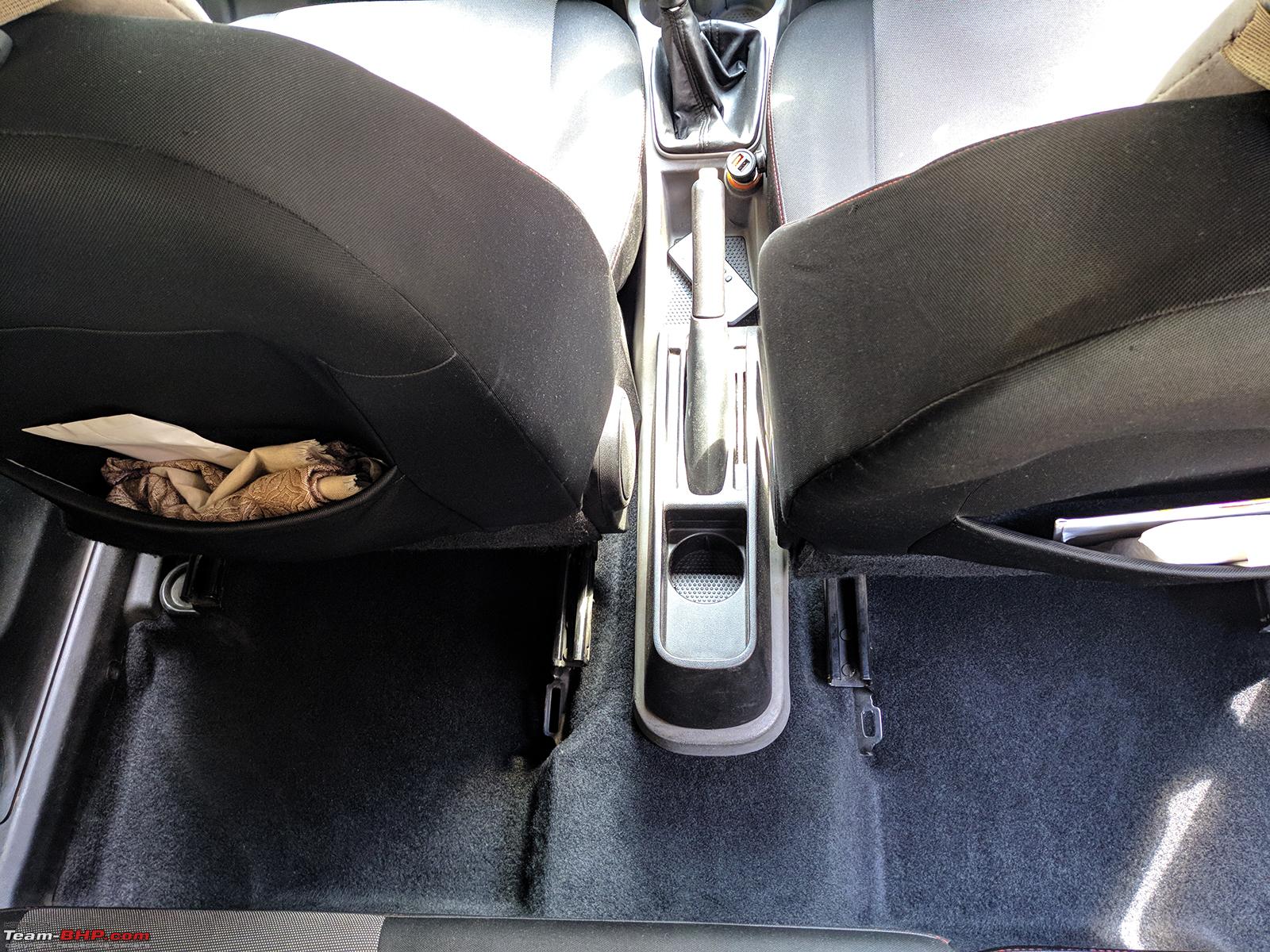

Interior vaccum cleaning -

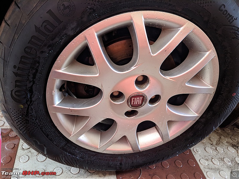

Toothbrush treatment for alloy wheels as well -

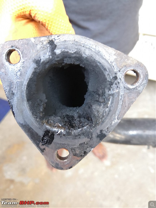

Mystery of check engine light!
While driving down from Bangalore to Trivandrum, the check engine light came on midway at Madurai. Being an election day in TN (No, I didn't skip voting - did that in my hometown. :)) there were no shops or service centers open, and also I couldn't find anything wrong with the measurables or performance of the car - so I called up my trusted FNG and decided to drive down the rest of the distance into Trivandrum.
Car covered the remaining 300kms in about 6 hours with no performance issues, and the check engine light also disappeared after being parked overnight. Being Easter weekend, FCA workshop was closed for an extended weekend, and I got it checked afterward - they could find only two errors (1. Glow plugs which were giving out separate warnings and I had already decided to replace all four during next service and 2. EGR warning. EGR was last cleaned closer to the 120k service, but the car has been used for a lot of city driving since then - and that could be the reason for the error. However, this wasn't showing as active anymore and the SA also advised to get it cleaned during the upcoming service).
Did another 400kms of two-lane highway run afterward, and the warning lamp has not made an appearance since.
400 kms of highway run mentioned in the last sentence was on the two lane highways in Kerala, however the warning lamp showed up again while driving from Kerala to Karnataka post another 400kms of continous running - so it really has to be the EGR at fault I believe.
A thin line between genius and insanity - Fiat Grande Punto 90HP - 2,00,000 km up! Edit: Sold-img_20190505_124258.jpg
Will get the EGR checked and cleaned during the upcoming service. There are more issues that need attention as well this time.

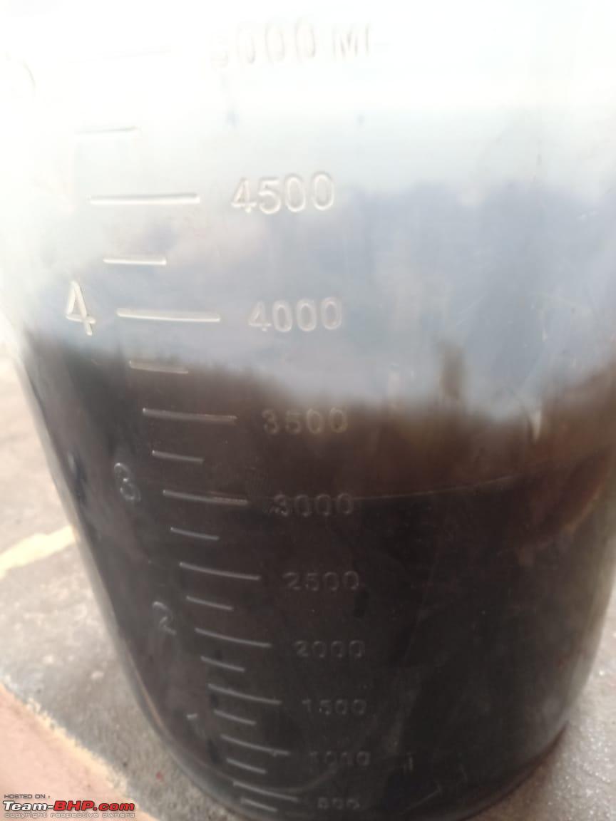

Thankfully the car is not drinking oil yet. Amount of oil drained after 10k kms of running -
No wonder the check engine light was getting triggered. Condition of the EGR and inlet manifold was really nasty thanks to all the city driving recently. Was in much better condition when I did the first cleaning at 120k!

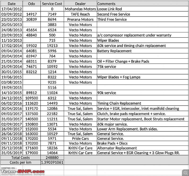

Costs Involved -

Check engine light was triggered by the EGR sensor. And not very surprising if you see the above images. :D
60k kms of mostly city driving seems to have chocked it bad, whereas the first EGR cleaning I had done only post 120k kms (with a lot of highway driving involved).
