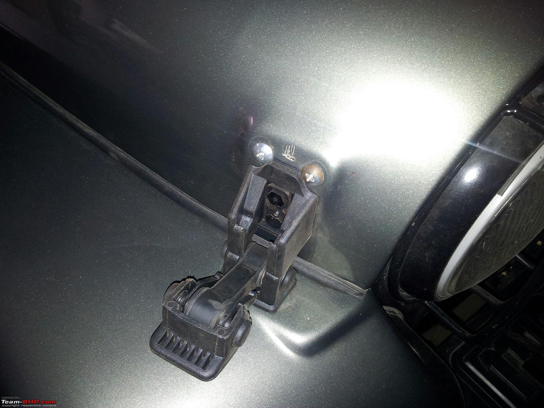

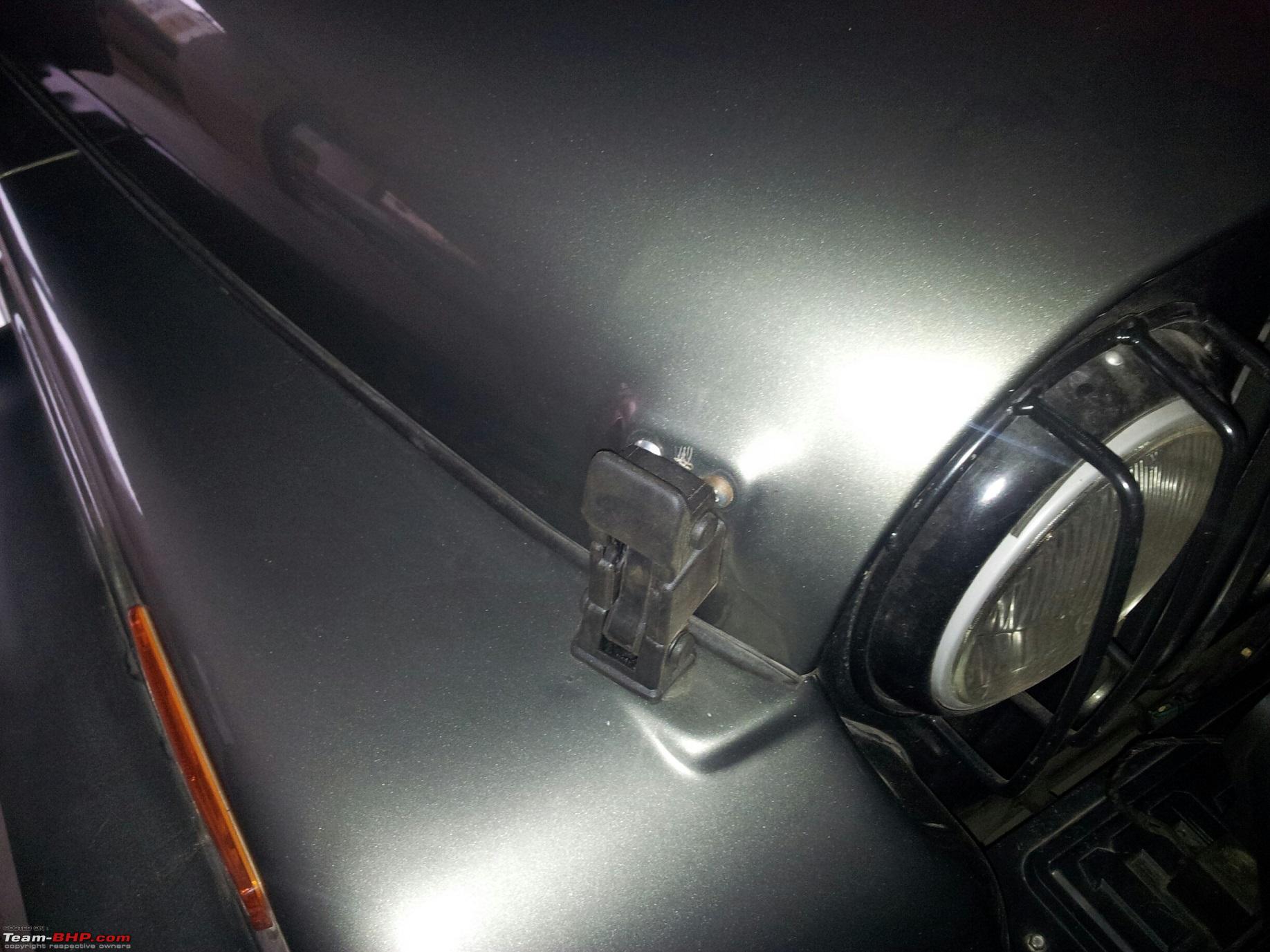

A couple of close-up images of the Rugged Ridge hood latches from Jeep Wrangler:
Attachment 1135737
Attachment 1135738
Attachment 1135739
