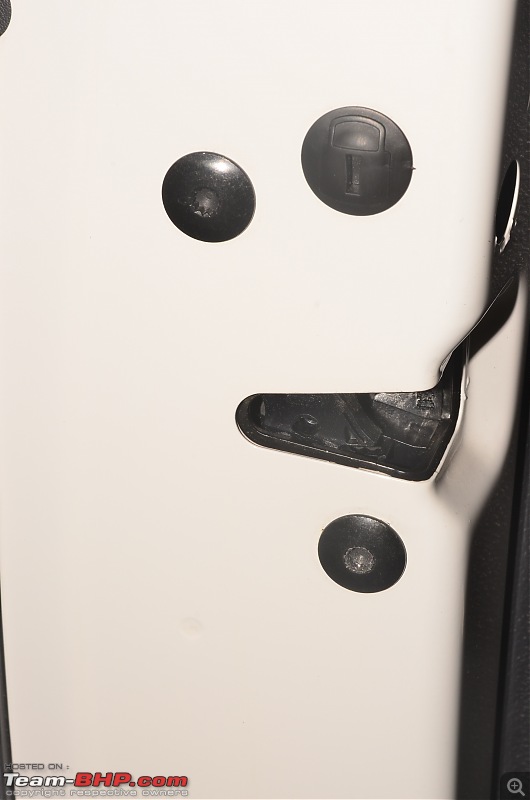

1. Right side Rear door failed to lock!
Problem found with the door lock actuator. Same was ordered and replaced under warranty.
Actuator took about a week to arrive, once ordered. Until then, I was manually locking the door, through the manual lock provision at the side of the door (concealed by a rubber cap). Use ignition key and turn it clock-wise about 10 degrees, to lock. Use remote to un-lock.
VW Jetta 2.0 TDI HL MT - Now with Bilsteins and Pete's Remap! EDIT: Now sold!-dsc_2303resize.jpg
VW Jetta 2.0 TDI HL MT - Now with Bilsteins and Pete's Remap! EDIT: Now sold!-dsc_2304resize.jpg

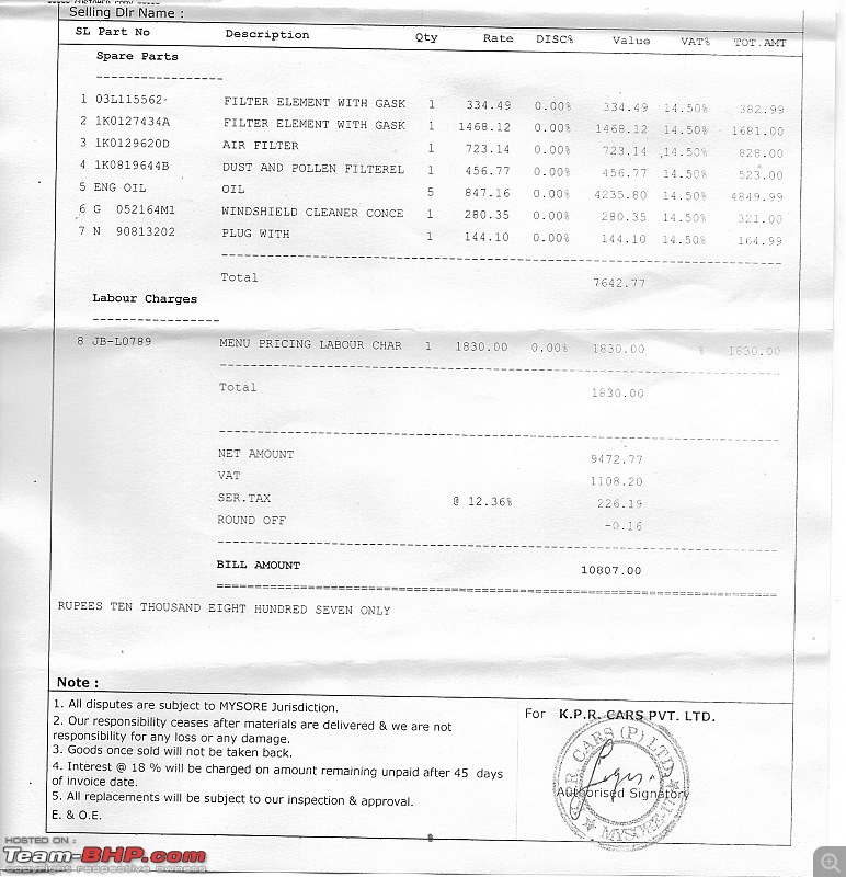

Update: ODO @ 29K Kms
Last 2000 Kms has been uneventful. Engine Oil level has not dropped since last service and so, Oil top-up was not required at all. Problem with AC has been completely resolved, after replacing solenoid and the car is as good as new..
Second Oil-change service was carried out @ 28K on the ODO. All filters were replaced. Brake pads / discs were good enough till the next Oil-change service and did not require to be replaced. Service costed me about 10.8k without wheel balancing / alignment. Service was done at KPR Cars, Mysore; Overall experience was excellent.
