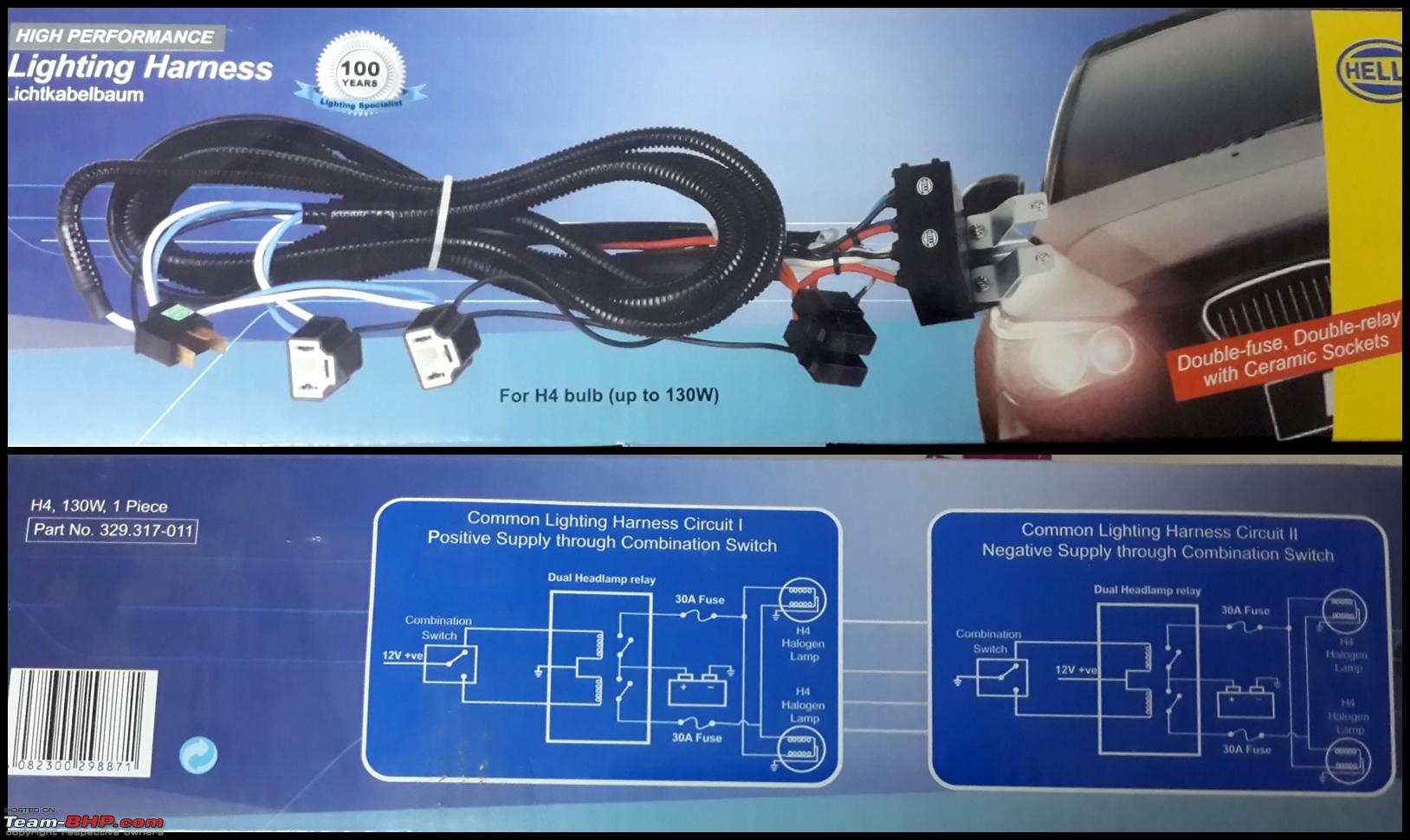

Wiring harness kit: Hella (Sustainable upto 130W).
Bulbs: Philips Rally 100/90W H4 (P43t base).
The kit consists of:
  • Wiring harness neatly covered and insulated,
  • Ceramic Holders,
  • 2 Heavy Duty 30A Fuses for each Beam,
  • A Relay.

Hella Wiring Harness kit:
The story of a Blue Streak a.k.a Maruti Swift ZDi (Torque Blue). 1,20,000 km up & now sold-20150328_200607vert.jpg

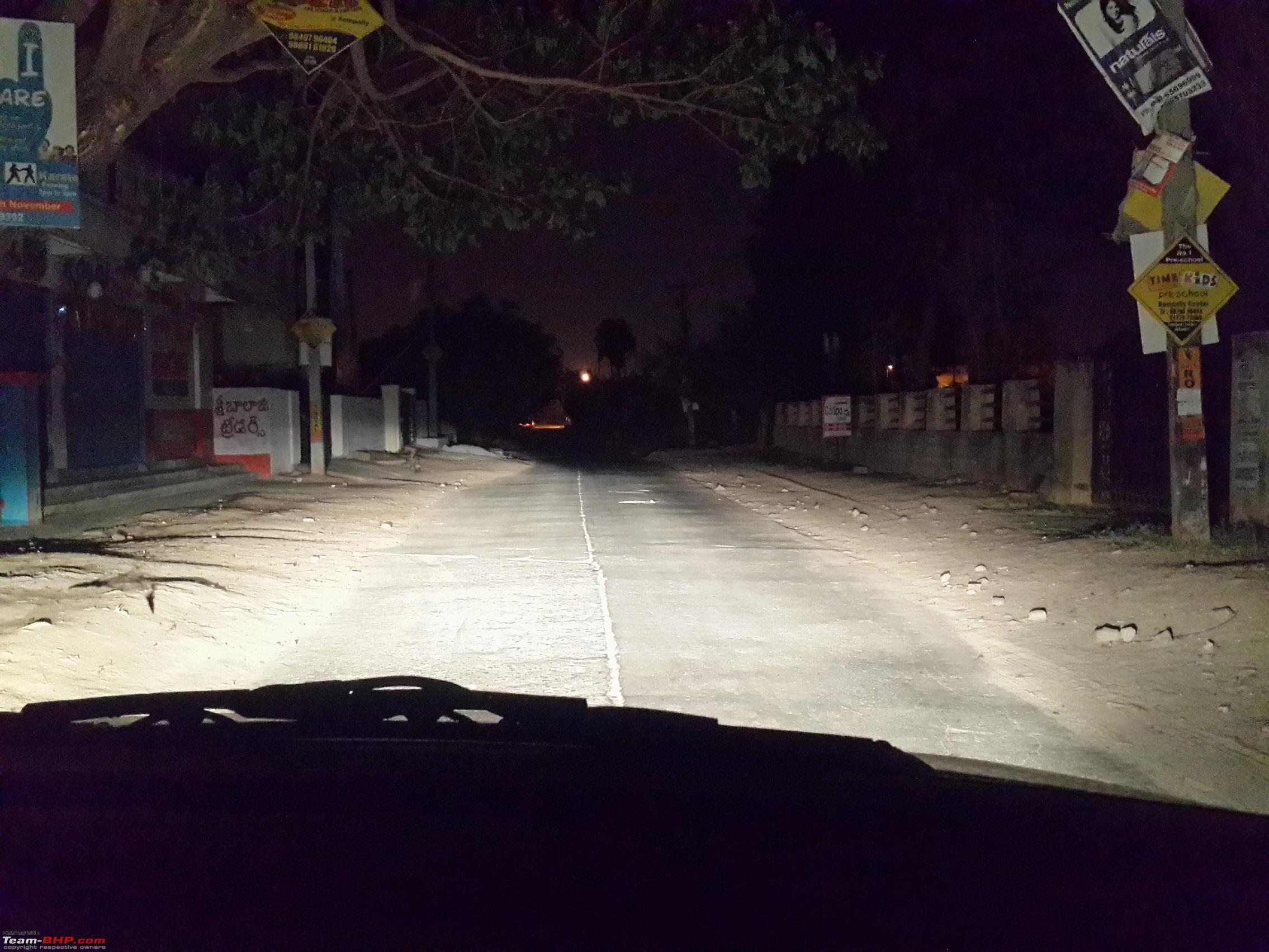

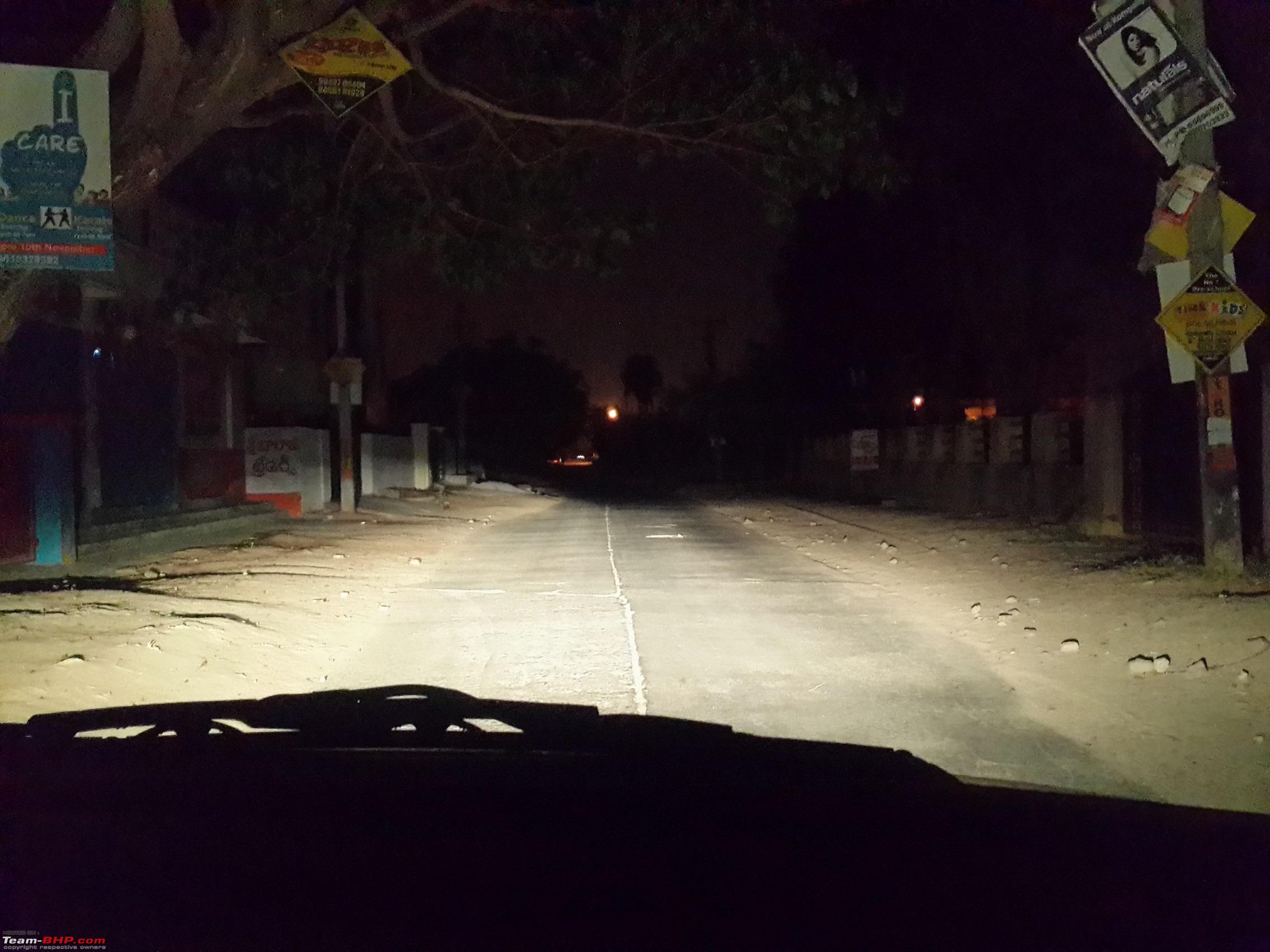

As I could get a clear stretch near home, clicked a few pictures to show the headlamp spread and view from driver's eye.
Low Beam ONLY:
The story of a Blue Streak a.k.a Maruti Swift ZDi (Torque Blue). 1,20,000 km up & now sold-low-beam.jpg
High Beam ONLY:
The story of a Blue Streak a.k.a Maruti Swift ZDi (Torque Blue). 1,20,000 km up & now sold-high-beam.jpg

I am mostly on Low beam as it is adequate but do get an itch when I see people driving with high beam + fog lamps ON at nights. One flick of the switch they do switch to low beam.
I find this setup good till now (VFM too) and have done over 300 kms of driving in night with this setup. Yet to see excessive heating or any such issues with the headlamps/reflectors.

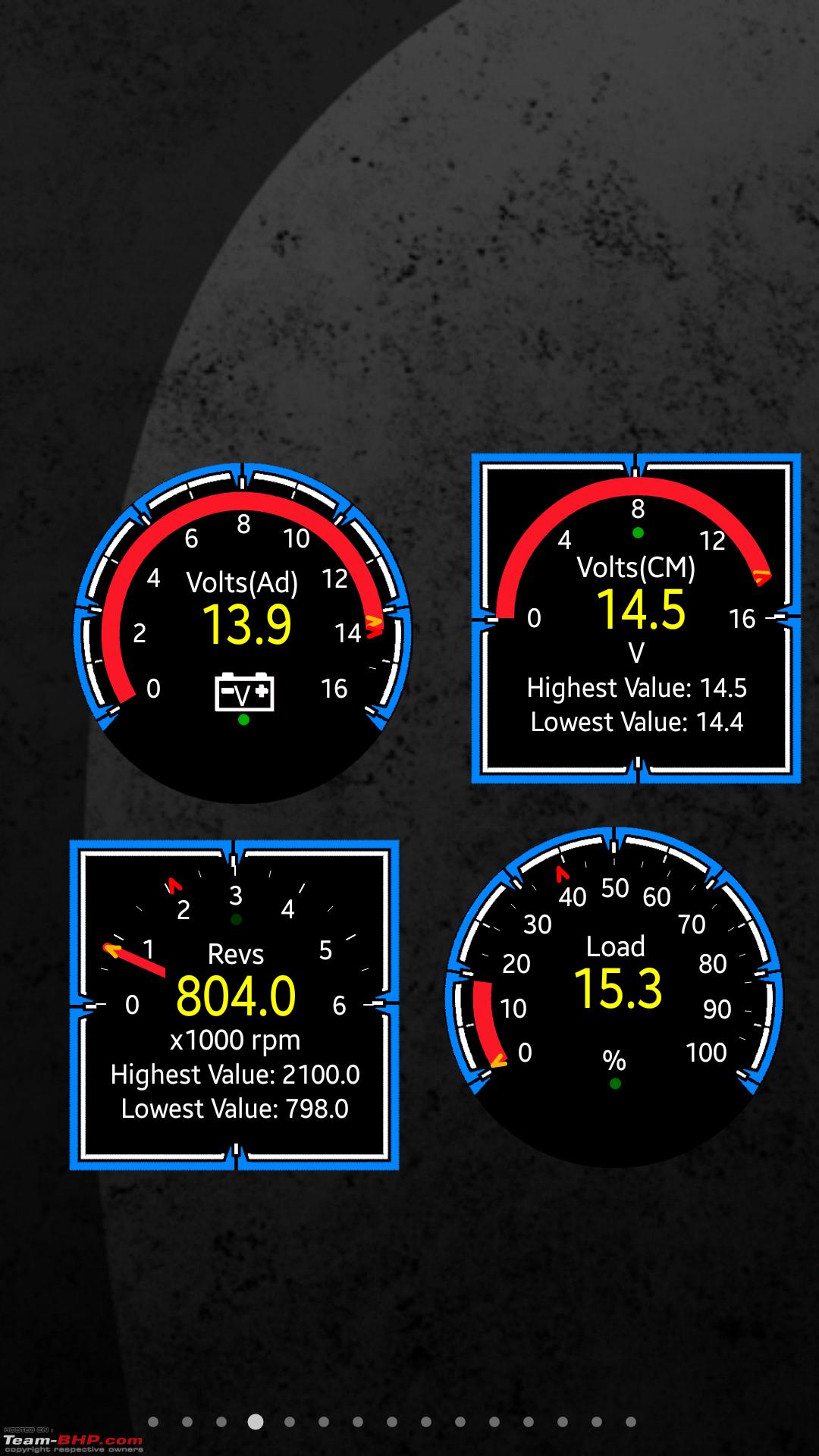

With the head lamp upgrade I wanted to see how is there a difference in the load on the engine when the headlamps are ON and OFF.
What are the effects on the battery etc is what I wanted to know hence plugged-in the OBD reader to see how the values for Load and Battery Voltage behave during the following conditions:

Looking at the below reading:
I do feel that it is wise to not keep the car idling and having the headlights ON as it will be consuming unnecessary fuel plus generate heat that would ruin the reflectors and headlight.
