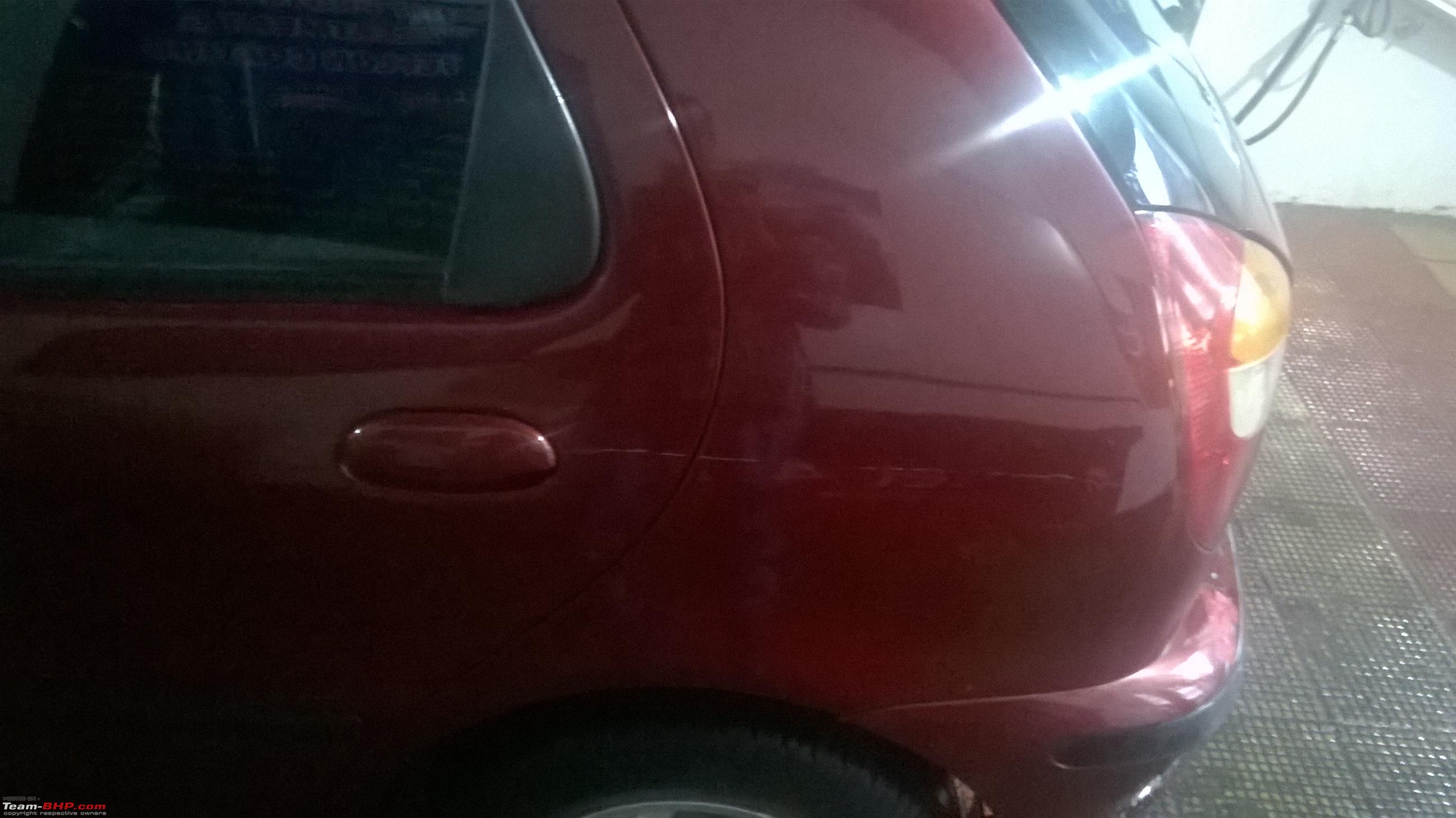

Some of the injuries in it's life in Mumbai
Not sure when did I get these scratches but most of it has been erased with the recent paint treatment. However, there is a paint chip / crack which has been temporarily fixed with the insulation tape. Details in the above thread.

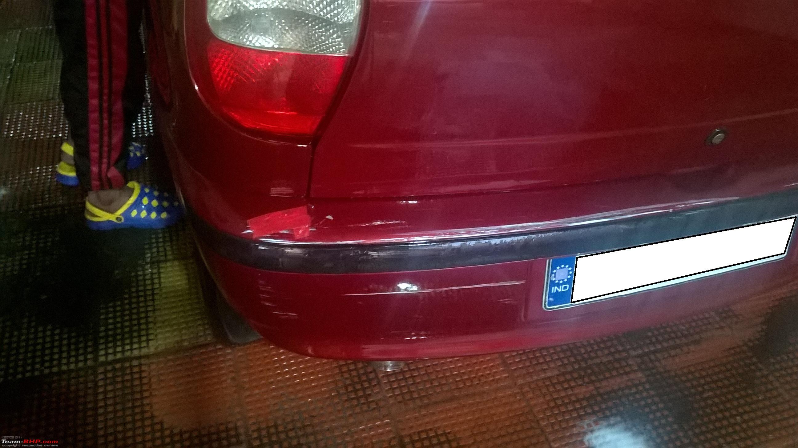

A stupid private bus driver jammed a biker between his bus and my car. I had no choice but to move the car that much to release the bike handle.
