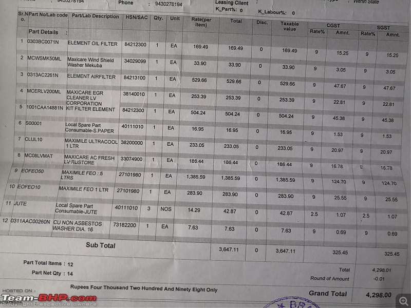

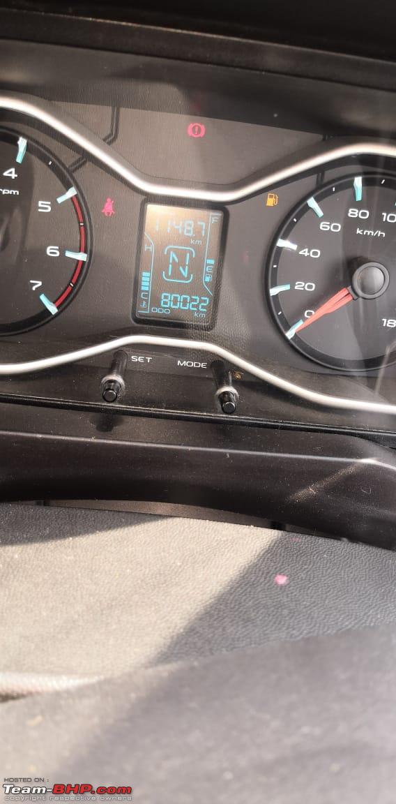

Done with the 80K service.
Apart from regular consumables, nothing was changed. I think, the clutch may need replacement in another 10 to 20K, but that is it.
