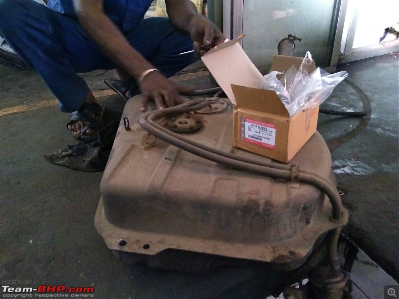

I was anyways relaxed as I knew my car was in safe hands. My SA, Dhiraj began the diagnostics immediately, and it was confirmed, there was a drop in fuel pressure.
The love of my life - A 2000 Maruti 800 DX 5-Speed. EDIT: Gets export model features on Pg 27-img_20180507_145353758.jpg
The tank was lowered, probably for the first time in its life.
The love of my life - A 2000 Maruti 800 DX 5-Speed. EDIT: Gets export model features on Pg 27-img_20180507_155842945.jpg
A minor leak was observed.
The love of my life - A 2000 Maruti 800 DX 5-Speed. EDIT: Gets export model features on Pg 27-img_20180507_160045002.jpg
The suction filter was badly choked with deposits, which burnt the solenoid.
The love of my life - A 2000 Maruti 800 DX 5-Speed. EDIT: Gets export model features on Pg 27-img_20180507_160307335.jpg
Condition of the internals of the fuel tank, initially we thought it was rust. But later it was revealed, it's sedimentation. All 18 years of collection
The love of my life - A 2000 Maruti 800 DX 5-Speed. EDIT: Gets export model features on Pg 27-img_20180507_160619098.jpg

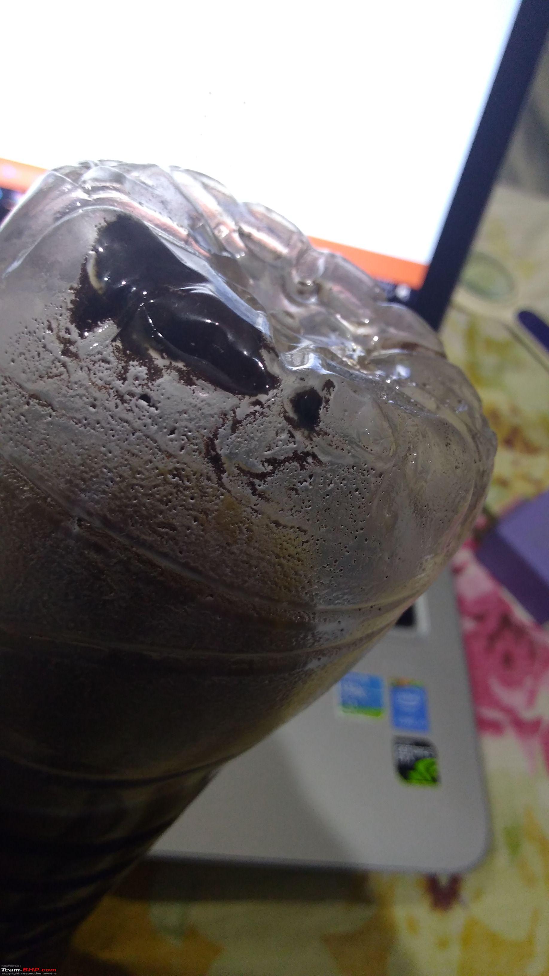

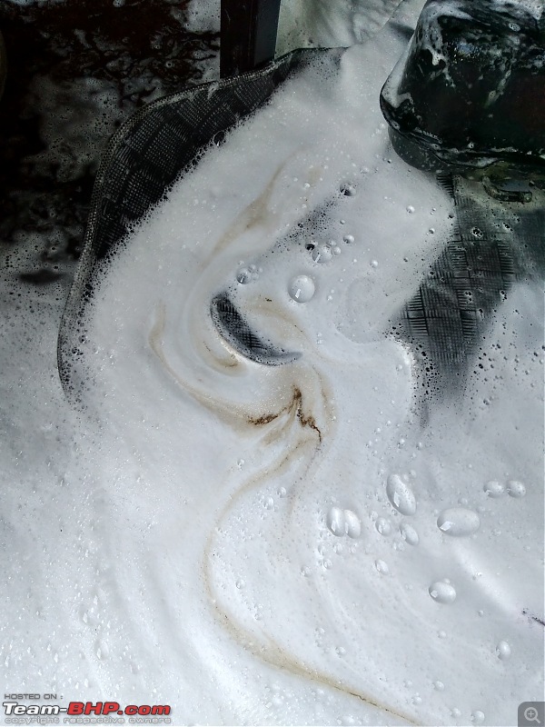

We decided to clean the tank comprehensively and then check for any rusting. I was cleaned with diesel, soap and what not. What helped was the pressurised jet.
The love of my life - A 2000 Maruti 800 DX 5-Speed. EDIT: Gets export model features on Pg 27-img_20180507_163755289.jpg
The love of my life - A 2000 Maruti 800 DX 5-Speed. EDIT: Gets export model features on Pg 27-img_20180507_163801160.jpg
Even after 5th round of washing, the dirt was still coming
The love of my life - A 2000 Maruti 800 DX 5-Speed. EDIT: Gets export model features on Pg 27-img_20180507_165050295.jpg
The love of my life - A 2000 Maruti 800 DX 5-Speed. EDIT: Gets export model features on Pg 27-img_20180507_165053927_hdr.jpg
The love of my life - A 2000 Maruti 800 DX 5-Speed. EDIT: Gets export model features on Pg 27-img_20180507_165058490_hdr.jpg

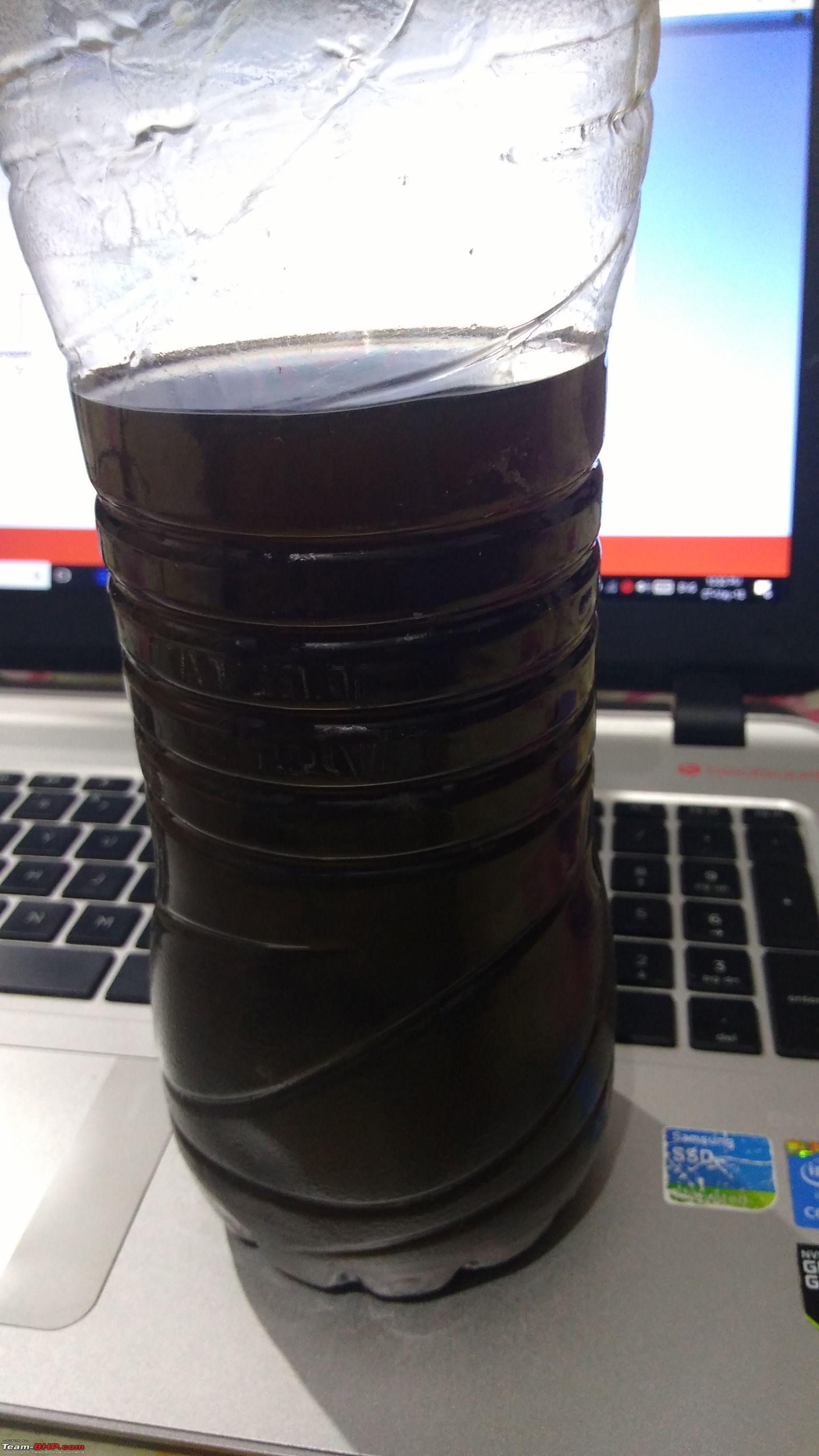

A sample of the fuel which came out:
The love of my life - A 2000 Maruti 800 DX 5-Speed. EDIT: Gets export model features on Pg 27-img20180507wa0136.jpeg
The love of my life - A 2000 Maruti 800 DX 5-Speed. EDIT: Gets export model features on Pg 27-img20180507wa0138.jpeg
The love of my life - A 2000 Maruti 800 DX 5-Speed. EDIT: Gets export model features on Pg 27-img20180507wa0142.jpeg

Thanks a lot for your help. This was the part which was changed yesterday. It's billed to me as Pump Assembly, Fuel.
The love of my life - A 2000 Maruti 800 DX 5-Speed. EDIT: Gets export model features on Pg 27-img_20180509_103144162.jpg
Since we had changed the fuel pump, we didn't bother checking the fuel pressure again. And that turned out to be a blunder.
The new pump which was changed yesterday was faulty right out of the box, which was confirmed by the unusually high priming noise and low fuel pressure. Today, we changed it again, checked the fuel pressure and everything was found OK. Let's hope this solves the issue.
The love of my life - A 2000 Maruti 800 DX 5-Speed. EDIT: Gets export model features on Pg 27-img_20180509_101908207.jpg
