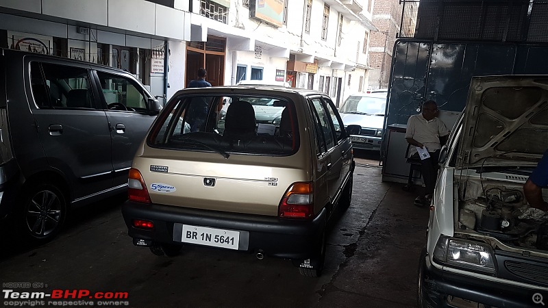

Rear wiper and Fog Light Story: One day in 2014, thanks to a friend in MSIL, I got this:
The love of my life - A 2000 Maruti 800 DX 5-Speed. EDIT: Gets export model features on Pg 27-20170303-20.53.33.jpg
I had never seen it in pics, so the search began and I came to know that MSIL used to export huge numbers to Egypt. So I downloaded most of the pics that they had put online.
So it was a long cherished dream, but the issues were, my self imposed restrictions:
1. Installation had to be clean and OEM. Using jugaads, many people have installed rear wiper setups, but they all looked out of place and afterthought.

2. Getting all parts were a pain. Maruti has restricted sale of many parts in India as they are export specific. After getting shipped from Japan, some small parts have become extremely expensive.
3. I wished to retain the original paint. Any sort of repaint was a strict no no.
So after almost 3 years of planning, R&D and parts collection, I was finally ready in March. Another issue was, I had no measurement of the hole location. That was taken care of purchasing a scrapped Boot door from scrapyard and experimenting on it. We did many mistakes on that, and I was glad we decided to experiment on another boot.
Another challenge which came in our way, was that we needed one bracket inside the hatch(wiper in 800 was link based system, not directly on motor). But welding it meant original paint gone. After some research, found these JB weld cold weld formula, and a friend coming from US brought it down. It's strength can easily endure 4000PSI and I personally checked that metal pasted by JB weld could take around 150kgs without breaking. So mission accomplished.
So finally after many discussions, denter told he can carefully make a hole with sharp chisel and hammer. It took him 3 hours of careful hammering and filing, but the result was well worth it. The hole is as good as OEM.
The love of my life - A 2000 Maruti 800 DX 5-Speed. EDIT: Gets export model features on Pg 27-20180514_170836.jpg
The love of my life - A 2000 Maruti 800 DX 5-Speed. EDIT: Gets export model features on Pg 27-20180514_170843.jpg
Long story cut short, today we installed the setup. I'll be detailing every step from day 1, but for the time being, enjoy some pics:
Admiration begins as soon as the setup is on:
The love of my life - A 2000 Maruti 800 DX 5-Speed. EDIT: Gets export model features on Pg 27-20180517_161834.jpg
The love of my life - A 2000 Maruti 800 DX 5-Speed. EDIT: Gets export model features on Pg 27-20180517_171335.jpg
The love of my life - A 2000 Maruti 800 DX 5-Speed. EDIT: Gets export model features on Pg 27-20180517_171347.jpg
The car stayed out in public for just half an hour and I stopped at 3 places, I was questioned by 12 people. It surely has become a headturner.
However, not everything is perfect. Some quirks:
1. Export model cars didn't get HMSL. Indian versions had. The wiper arm covers some 5% area of the HMSL if viewed from behind.
2. I have noticed most of the Indian cars get fogs on right side or in middle. Not sure what the rule says, but this is what all 800s RHD or LHD got, so I had little options.

Wow, your M800's rear has really transformed after the installation of the rear wiper & the unique bumper mounted fog light. The thing I like most about your mods are that you only use OEM parts, no matter how difficult or costly it gets . No aftermarket juggad can match an OEM fit, the OEM fit looks so much better.
I personally think that a hatchback doesn't look complete without a rear wiper & sadly this feature has gone missing from many A-segment hatchbacks in India. Even premium hatchbacks like the Hyundai i20 only has a rear wiper in the top Asta (O) variant.
I noticed the placement of the wiper arm w.r.t the HMSL just because you mentioned it, otherwise I wouldn't have noticed. So, in short I believe this isn't something that you should be bothered about. Maybe in the future you could move up the HMSL from the bottom of the glass to the top, like the Alto 800/K10.

Thanks a lot. True, nothing beats an OEM looking setup.
Yes it's not that evident in real life. Alto 800/K10 setup wont work in 800, the boot won't close if I mount it like that.
