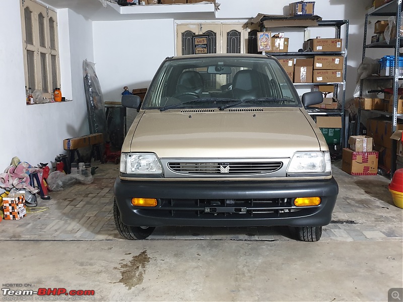

Last set of maintenance on GG: Pictures are self explanatory hence I'll directly proceed with pics.
1. Deep Cleaning of front end, along with some refurbishing. Replaced the Heat exchanger foams, straightened out the fins, and basically the entire engine bay was given a nice clean after removing the bumper.
The love of my life - A 2000 Maruti 800 DX 5-Speed. EDIT: Gets export model features on Pg 27-1.jpg
Cleaned and detailed the bay:
The love of my life - A 2000 Maruti 800 DX 5-Speed. EDIT: Gets export model features on Pg 27-1a.jpg
2. Similar treatment was given to the wheel wells, alloys, lights etc. Each part was removed, cleaned, restored and fixed back. :
The love of my life - A 2000 Maruti 800 DX 5-Speed. EDIT: Gets export model features on Pg 27-2.jpg
The love of my life - A 2000 Maruti 800 DX 5-Speed. EDIT: Gets export model features on Pg 27-3.jpg
The love of my life - A 2000 Maruti 800 DX 5-Speed. EDIT: Gets export model features on Pg 27-15.jpg
The love of my life - A 2000 Maruti 800 DX 5-Speed. EDIT: Gets export model features on Pg 27-16.jpg
Look once the basics were done.
The love of my life - A 2000 Maruti 800 DX 5-Speed. EDIT: Gets export model features on Pg 27-4.jpg
The love of my life - A 2000 Maruti 800 DX 5-Speed. EDIT: Gets export model features on Pg 27-5.jpg
This was followed by a regular foam wash and detailing using simple meguiars products:
The love of my life - A 2000 Maruti 800 DX 5-Speed. EDIT: Gets export model features on Pg 27-14.jpg
The metallics:
The love of my life - A 2000 Maruti 800 DX 5-Speed. EDIT: Gets export model features on Pg 27-14a.jpg
3. The battery(Amaron Flo) is now nearing 5 year mark. Month of Manufacture is August 2015. While there was no issue, the extended lockdown did give me an opportunity to try regeneration using Bosch C7. Also topped up the battery before recharging to correct levels and left the vent caps open since it gets close to 16V for 4 hours and lots of bubbling happens. It did take quite a bit of distilled water and this should help in extending its life.
Post regeneration, I left the battery idle for some time followed by trickle charging overnight:
The love of my life - A 2000 Maruti 800 DX 5-Speed. EDIT: Gets export model features on Pg 27-6.jpg
The love of my life - A 2000 Maruti 800 DX 5-Speed. EDIT: Gets export model features on Pg 27-7.jpg
While the battery was out, restored the battery holder rods.
Before:
The love of my life - A 2000 Maruti 800 DX 5-Speed. EDIT: Gets export model features on Pg 27-8.jpg
After:
The love of my life - A 2000 Maruti 800 DX 5-Speed. EDIT: Gets export model features on Pg 27-9.jpg
4. Distributor cleaning: The distributor was last attended to months ago. So checked out its condition and except some dust, there was nothing alarming. Cleaned the dust and replaced the gasket to prevent rust ingress:
The love of my life - A 2000 Maruti 800 DX 5-Speed. EDIT: Gets export model features on Pg 27-10.jpg
The love of my life - A 2000 Maruti 800 DX 5-Speed. EDIT: Gets export model features on Pg 27-11.jpg
5. Rusty Fuel pipe panels: These hide the metal fuel lines, and it was never opened in my car. During cleaning, I opened and found some rust as there is no protection on the metal. After removing the rust, treated it with Zinc spray followed by anti rust:
The love of my life - A 2000 Maruti 800 DX 5-Speed. EDIT: Gets export model features on Pg 27-12.jpg
The love of my life - A 2000 Maruti 800 DX 5-Speed. EDIT: Gets export model features on Pg 27-13.jpg
The love of my life - A 2000 Maruti 800 DX 5-Speed. EDIT: Gets export model features on Pg 27-13a.jpg
6. Upgraded to 1W number plate LEDs, from older 0.5W. These are much brighter:
The love of my life - A 2000 Maruti 800 DX 5-Speed. EDIT: Gets export model features on Pg 27-17.jpg
Before:
The love of my life - A 2000 Maruti 800 DX 5-Speed. EDIT: Gets export model features on Pg 27-18.jpg
After:
The love of my life - A 2000 Maruti 800 DX 5-Speed. EDIT: Gets export model features on Pg 27-19.jpg
7. Finally found proper dust caps which fit nicely on 800s strut tower. These are from 3rd Gen Swift:
The love of my life - A 2000 Maruti 800 DX 5-Speed. EDIT: Gets export model features on Pg 27-20.jpg
The love of my life - A 2000 Maruti 800 DX 5-Speed. EDIT: Gets export model features on Pg 27-21.jpg
After these, GG was ready for a much needed photo shoot, and it was time for Unlock 1.0!

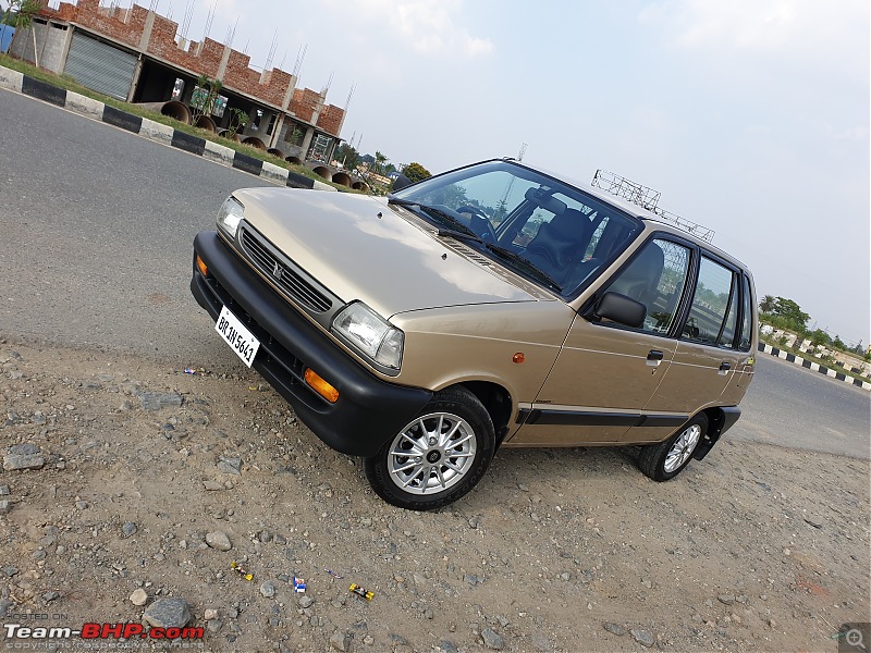

Time for some fun. BHPian sumitsinha0280 joined me later with his 92 Maruti 800:
The love of my life - A 2000 Maruti 800 DX 5-Speed. EDIT: Gets export model features on Pg 27-20200608_154238.jpg
The love of my life - A 2000 Maruti 800 DX 5-Speed. EDIT: Gets export model features on Pg 27-20200608_154251.jpg
The love of my life - A 2000 Maruti 800 DX 5-Speed. EDIT: Gets export model features on Pg 27-20200608_154525.jpg
The love of my life - A 2000 Maruti 800 DX 5-Speed. EDIT: Gets export model features on Pg 27-20200608_155812.jpg
The love of my life - A 2000 Maruti 800 DX 5-Speed. EDIT: Gets export model features on Pg 27-20200608_162134.jpg
The love of my life - A 2000 Maruti 800 DX 5-Speed. EDIT: Gets export model features on Pg 27-20200608_162401.jpg
The love of my life - A 2000 Maruti 800 DX 5-Speed. EDIT: Gets export model features on Pg 27-20200608_162413.jpg
The love of my life - A 2000 Maruti 800 DX 5-Speed. EDIT: Gets export model features on Pg 27-20200608_162433.jpg
The love of my life - A 2000 Maruti 800 DX 5-Speed. EDIT: Gets export model features on Pg 27-20200608_162449.jpg
The love of my life - A 2000 Maruti 800 DX 5-Speed. EDIT: Gets export model features on Pg 27-20200608_162632.jpg
The love of my life - A 2000 Maruti 800 DX 5-Speed. EDIT: Gets export model features on Pg 27-20200608_162835.jpg
The love of my life - A 2000 Maruti 800 DX 5-Speed. EDIT: Gets export model features on Pg 27-20200608_162919.jpg
The love of my life - A 2000 Maruti 800 DX 5-Speed. EDIT: Gets export model features on Pg 27-20200608_163110.jpg
The love of my life - A 2000 Maruti 800 DX 5-Speed. EDIT: Gets export model features on Pg 27-20200608_163121.jpg
The love of my life - A 2000 Maruti 800 DX 5-Speed. EDIT: Gets export model features on Pg 27-20200608_163336.jpg
The love of my life - A 2000 Maruti 800 DX 5-Speed. EDIT: Gets export model features on Pg 27-20200608_163741.jpg
The love of my life - A 2000 Maruti 800 DX 5-Speed. EDIT: Gets export model features on Pg 27-20200608_173100.jpg
That's all for now.
