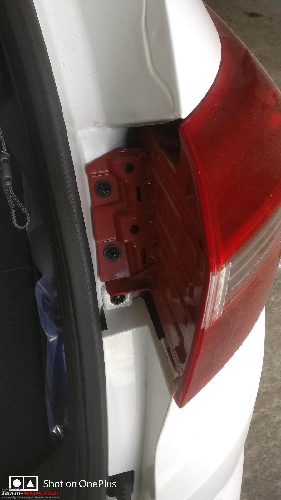

Screws that hold the tail light on the body are hidden underneath the black plastic cover
Hyundai Creta 1.6L CRDi SX(O) - An Ownership Log - Update: 1,00,000 km up!-img_20180313_075052.jpg
Insert a flat-head screwdriver on the two given notches to remove the cover
Hyundai Creta 1.6L CRDi SX(O) - An Ownership Log - Update: 1,00,000 km up!-remove-cover.jpg
Post removal of the cover, two star screws are seen that need to be removed to free the tail light
Hyundai Creta 1.6L CRDi SX(O) - An Ownership Log - Update: 1,00,000 km up!-cover-removed.jpg
