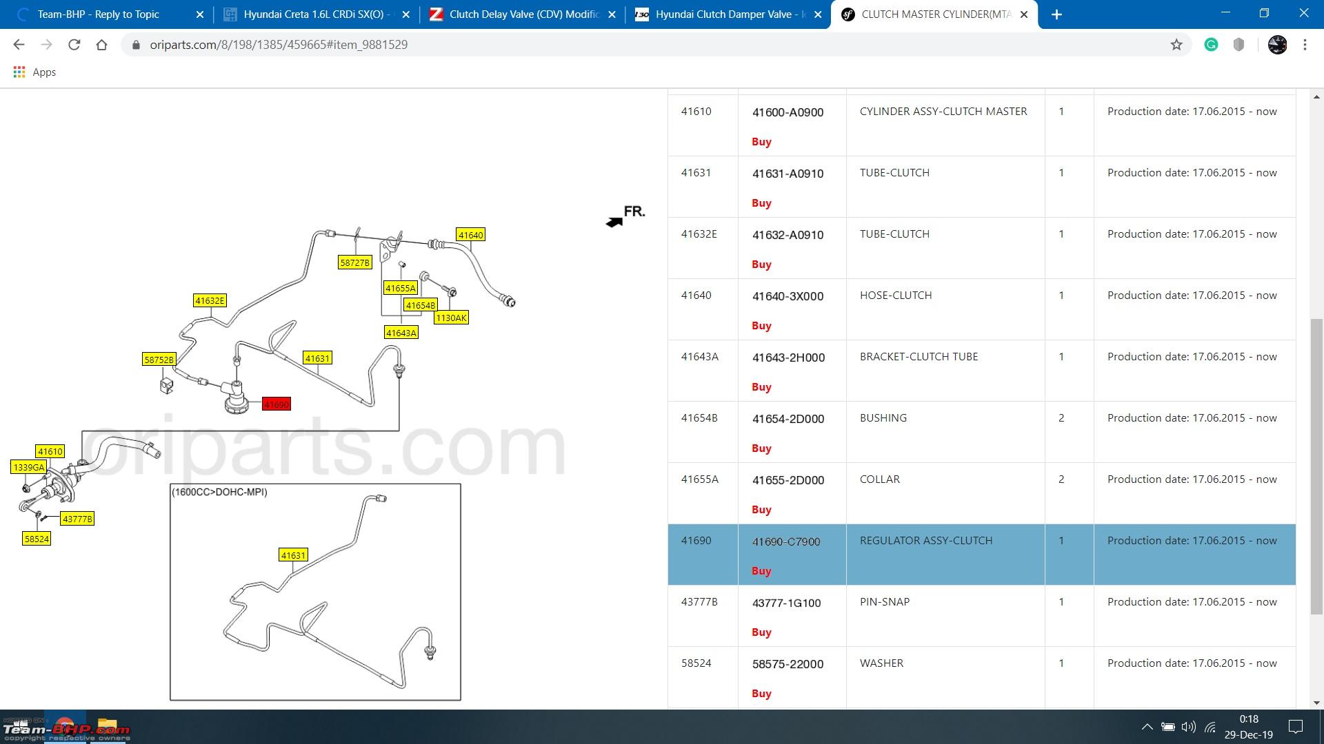

As per Boodmo
Hyundai Creta 1.6L CRDi SX(O) - An Ownership Log - Update: 1,00,000 km up!-regulator.jpg

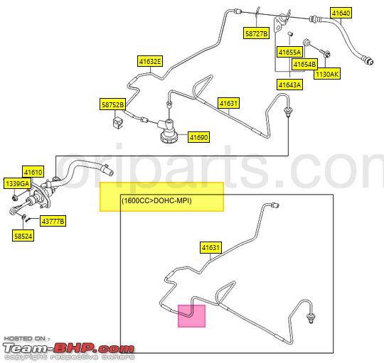

Not sure what Hyundai decided to add that piece in the clutch line when I don't see it in other cars from Maruti etc.
Seems it's interesting as per boodmo that 1600C>DOHC-MPI uses a different TUBE-CLUTCH (41631-A0900) without REGULATOR ASSY-CLUTCH. In addition majority of the clutch complaints i heard or read was from diesel users.
Yes sir. This 'regulator' is only for diesel engine model.
One can procure the petrol engine 'tube clutch' and replace it and should be a direct fit.
