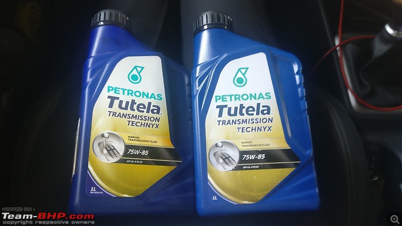

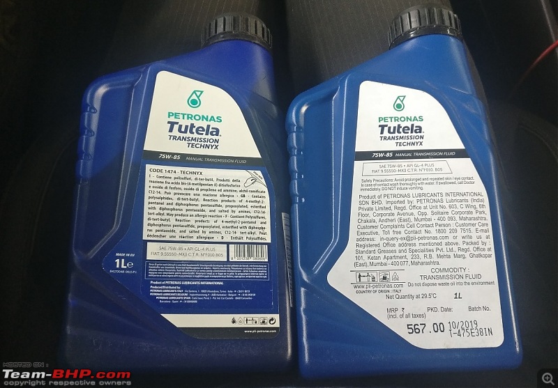

Bought the Petronas Tutela Technyx 75W85 gear oil locally from Fiat ASC (Thanks to pdma sir and his friend Nibed).
Gear shifts are back to normal and smooth as new.

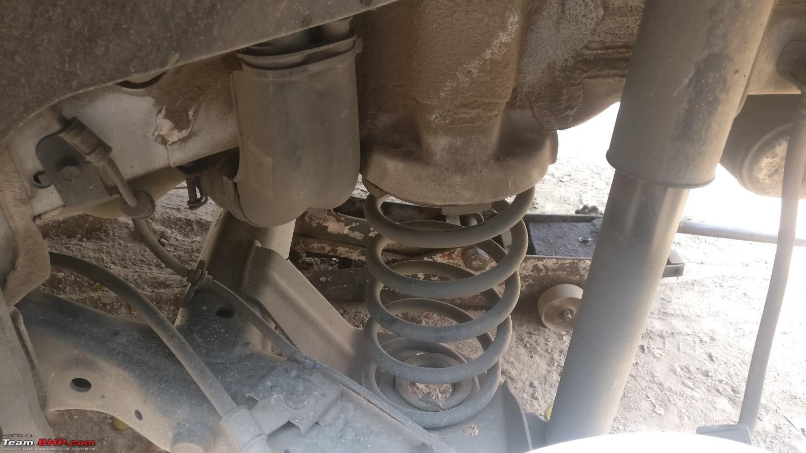

Got some time and the FNG was free too so went there and cleaned the drum brakes. Have placed an order on Boodmo for caliper pin grease.
