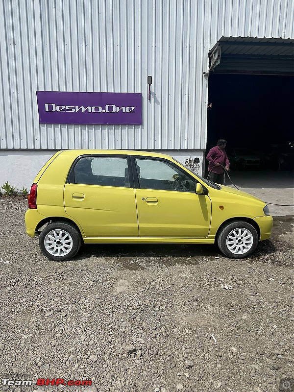

Kicking Off with Canary Yellow
When I first unbolted the doors, hood and bumpers, I felt a rush—this was going to be something special. Every rusty patch got ground out and welded, then sealed tight so this yellow won’t ever bubble again. I insisted on taking every panel out and heavy-duty masking (no half measures here), because overspray ghosts can ruin a weekend of hard work.

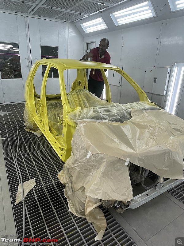

Three Stages to Showroom Shine
This was a multi-layer paint job. Old paint was stripped out to bare metal, then a coat of primer, smoothened out any uneven surfaces, sanded down again, base coat applied as this yellow comes with a special shade of base coat before the actual yellow is applied. What I realised is if you just paint it directly on grey primer the shade looks different. We laid down epoxy primer, slapped on a perfectly matched Fiat base coat, and finished with a tough clear.
The car underwent a proper painting process, it also had the state of the art baking process that was a sight to behold. Remember the child that waits for the cake to bake? That’s exactly how it felt.

In between each layer, I’d peer at the seams and get them to sand away any hint of orange peel—it felt like sculpting rather than painting. When sunlight catches it just right, it looks like liquid gold.

Exterior Transformation: Canary Yellow Brilliance
When it came to breathing new life into my Alto, the vision was clear: a standout Canary Yellow finish that turns heads without screaming for attention.
I am going to let the pictures do the talking here. Soak in the pure thrill of this project!
Project Alto Sport: How my little hatchback taught me what driving fun really feels like-img_1361.jpeg
Project Alto Sport: How my little hatchback taught me what driving fun really feels like-img_1362.jpeg
Project Alto Sport: How my little hatchback taught me what driving fun really feels like-img_1791.jpeg
Project Alto Sport: How my little hatchback taught me what driving fun really feels like-img_1795.jpeg
Project Alto Sport: How my little hatchback taught me what driving fun really feels like-img_1872.jpeg
Project Alto Sport: How my little hatchback taught me what driving fun really feels like-img_1976.jpeg
Project Alto Sport: How my little hatchback taught me what driving fun really feels like-img_2022.jpeg
Project Alto Sport: How my little hatchback taught me what driving fun really feels like-img_2023.jpeg
Project Alto Sport: How my little hatchback taught me what driving fun really feels like-img_1738.jpeg
Project Alto Sport: How my little hatchback taught me what driving fun really feels like-img_1009.jpeg
