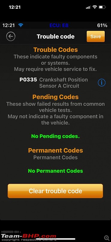

Hello All,
Thankfully most of the issues in my Grand Vitara 2.4L are sorted out.
One problem that I have currently is as follows:
Randomly once or twice a week while starting the car, it wont crank but a click sound will come and the Engine Check light will come on.
When I connect the OBD2 to see the error it says :
Error P0335
Crankshaft Position Sensor A Circuit
Has anybody faced this issue in the Grand Vitara 2.4L ?
If I take out the key and put it back in it starts normally and runs normally.
After some days randomly the error will come again.
The engine check lite goes off on it's own after the car is left standing for some time, or I can clear the error through the OBD2 also.
Yesterday I took the Grand Vitara to Motorcraft and they just removed the wiring coupler blew air into it and re-fixed it. This did not fix the problem as it happened again today.
I have told the Supervisor there to look for the Crankshaft Position Sensor Part No, and we will order it now.
Apparently it's a complicated task to remove the Crankshaft Sensor.
Any suggestions ?

Old 5th March 2022, 20:18   #1618
Leoshashi's Avatar
Join Date: Jul 2014
Posts: 5,674
Thanked: 41,809 Times
re: The First Grand Vitara on Team-BHP
Originally Posted by Styler View Post
Error P0335
DTC details for P0335 for J24B, diagnosis and troubleshooting:

Hope it helps.
Shashi
PS: most likely it's the sensor or the plate.

Old 6th March 2022, 18:49   #1619
Styler's Avatar
Posts: 519
Thanked: 718 Times
Thanks a lot Shashi ji
You have been the greatest support for so many years, right from the time I bought the Grand Vitara 2.0L
The Workshop also feels that we need to replace the Crankshaft Position Sensor.
Would there be a way to find the exact part no of what we need to order ?
Styler

Old 6th March 2022, 19:36   #1620
Leoshashi's Avatar
Join Date: Jul 2014
Posts: 5,674
Styler
33220-63J00
Shashi
