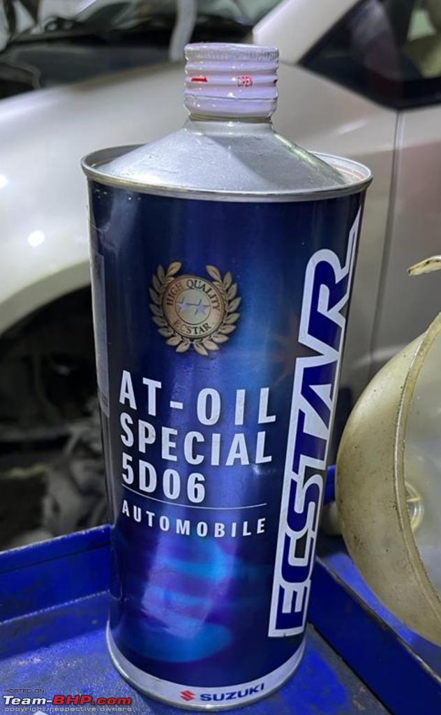

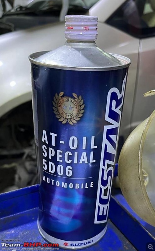

Friends, Following is the update on the GV servicing (Also had a chat with Mr.Sridhar and took his inputs). Servicing done at authorized MASS and job was done well.
1.Engine Oil changed to Shell Fully Synthetic (5W40): After change the engine is very smooth as the earlier oil was 5W30 semi-synthetic.
2.Coolant (SG) Non Amine - changed.
3.Brake Fluid GC1500AA - changed.
4.Brakes checked and Caliper serviced and calibrated.
5.Automatic Transmission (AT) Oil - changed: Part Code 99000-22810 AT OIL (5D06)
6.AC Compressor Oil: DENSO8(R134A) - Changed and AC GAS charged.
7.Throttle Body cleaned.
8.Changed the spark plugs to Iridium: Honda make directly imported from Japan got through a local dealer. Performance is good and firing is much smoother.

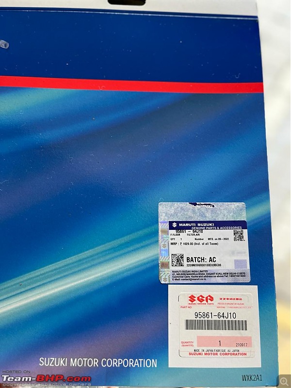

Following two were not readily not available. Ordered and got them in a week.
9.Cabin Air Filter - changed. Part Code: 95861-64J10.
10.Right Indicator lamp went faulty - Changed. Part Code: 36410-63J02.
Performance of GV now is much smoother and and love to ride this car..
