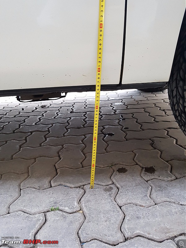

"thewhiteknight' seems to be too busy to post. I found some pictures of the OME install. So here they are:-
Struts comparo. OME is yellow.
Strut with spring
Wheel well height before
Wheel well height after
Front strut changed
Door sill bottom before
Door sill bottom after
Spring compressor

In addition to the lift of 20mm you will also recover between 30-40 mm of suspension height lost due to spring sag.
Ride stiffness, with the OME lift, is marginally more. But there is absolutely no difference in the handling characteristics. And one can put pedal to the floor on bad roads without having to worry about any scraping of the bottom.
Ask Ashok to be careful of the RH & LH units of the front strut. OME did mess up that consignment. They promptly sent the correct part, but it did take some time to come to Pune.
Due to that "thewhiteknight" did a trip to Goa with one OME strut and one OE strut, as he did not want to loose money on hotel bookings. All the springs and rear shocks were new OME. I drove my GV behind his for about 60 kms of highway and about 40 kms of side roads. I did not notice any abnormal rolling or pitching due to the different struts at the front. Suspension heights were also the same. So it seems that the springs majorily determine the ride height. "thewhiteknight" reported that he vehicle did not drag to one side. To be safe he did drive at sane speeds throughout.
The suspension setup of the GV is a real gem. Takes all sorts of abuse and behaves consistently.
