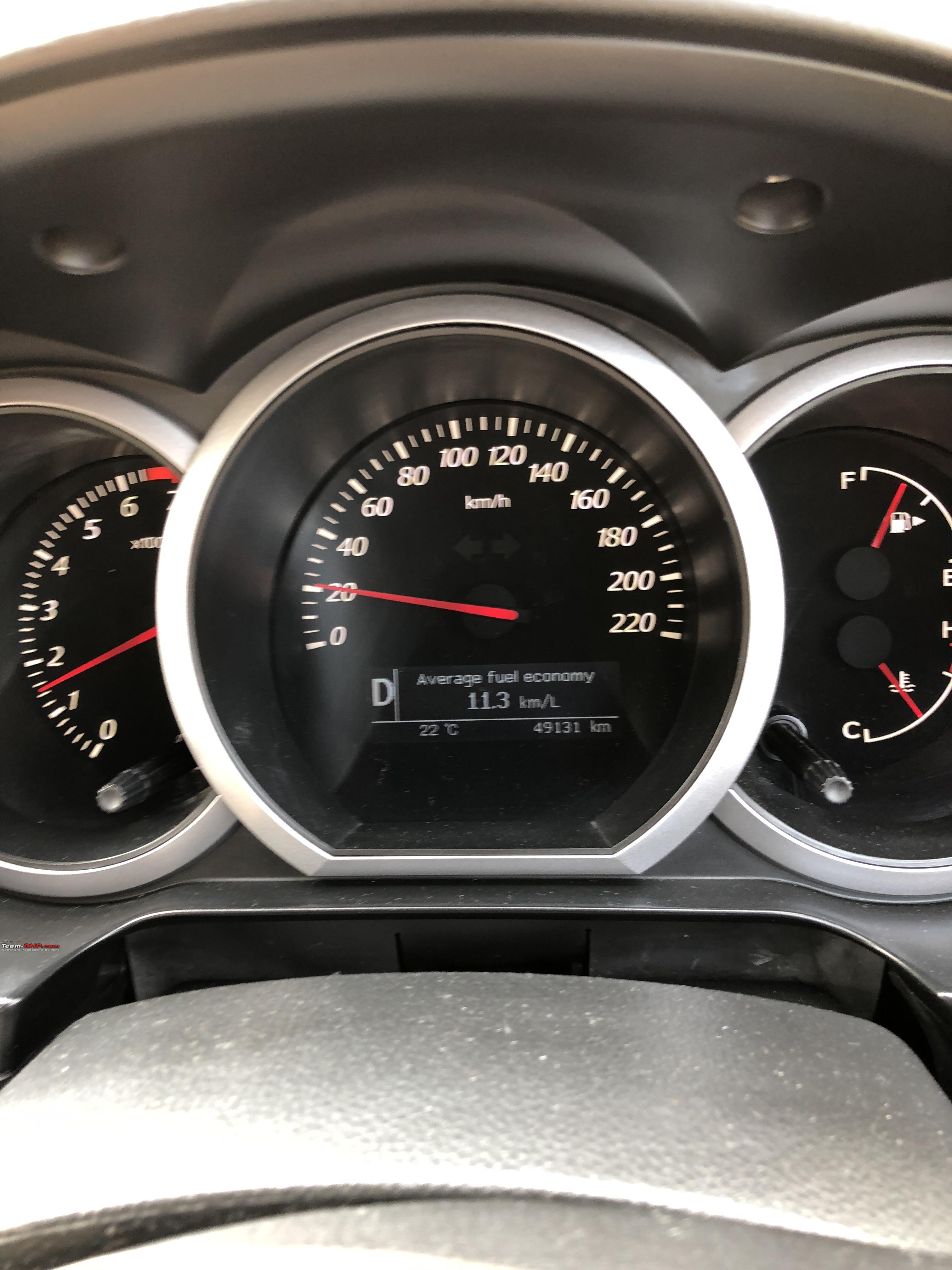

Not the smartest or strongest feature of a 2.4 liter auto box. Still 11.3 kilometers to a liter on the MID, which means atleast 10.75 in tank full calculations, is pretty decent. What say? From Bangalore to Kanakpura town.
