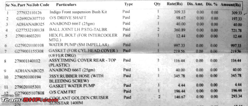

meh, turns out to be a classic case of tata worst case estimation. can't complain. they said the FICD and the Sensor dont need to be replaced for the time being, so should be okay.
The bill amount is suspiciously close to 7999 .
On the plus side, got along pretty well with the TASC here . The service advisor was very courteous. I observed the roles here are different as compared to kulathunkal.
In kulathunkal, the SA is the single point of contact. He checks out the car and prepares the checklist, talks to the customer, goes for the trial and test drive, and delivers the car, and they tend to be guys my age. Here, there were a few SA's, and the SA who attended to me was middle aged dude. The security here did the checklist, the SA talked to me and sent me with a mech for the initial and final test drive. He also had no qualms taking me into the service area.
The car is back to working condition, though there is a funny noise. Can't quite put my finger on it, and the language barrier is also a problem. Exceeded my traditionally low expectations
PFA the bill. Pardon the crappy camphone shots. dont have a scanner
Tata Indica DLG Turbo. EDIT: 17 years & 125k km up-bill1.jpg
Tata Indica DLG Turbo. EDIT: 17 years & 125k km up-bill2.jpg
Tata Indica DLG Turbo. EDIT: 17 years & 125k km up-bill3.jpg
