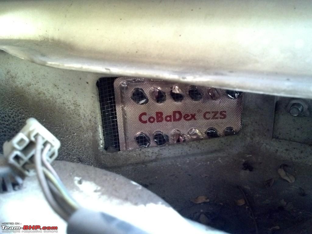

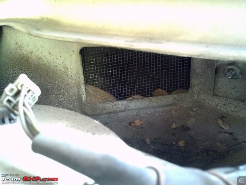

Blocking or reducing suction from outside Tata Safari
Originally Posted by ameaa View Post
Hi JK, Blocking or reducing suction from outside is pretty easy. The opening is inside the black fairing which sits below wiper arms below the front windsheild. You have to remove the wiper arms and then remove four screws for the fairing to come out. You can see the intake which already has a wire mesh. You can stick a sponge or a similar filter which can filter and same time reduce or filter the air which goes in. The screws are covered with rubber grommets which will come out if you poke with a screwdriver. Hope this helps..
Many thanks for the post.
Hope this helps the rest. Vitamin helps Safari too :P
1) The screws. You need a Philips screw driver and a spanner.
Tata Safari 2.2L at 1.5 lakh kms. Reclaiming continues without extended warranty UPDATE: Now Sold !-1.jpg
2) The wiper's nut without the rubber cover
Tata Safari 2.2L at 1.5 lakh kms. Reclaiming continues without extended warranty UPDATE: Now Sold !-2.jpg
3) The hidden screw after the bush was popped out
Tata Safari 2.2L at 1.5 lakh kms. Reclaiming continues without extended warranty UPDATE: Now Sold !-3.jpg
4) The mesh and leaves!
Tata Safari 2.2L at 1.5 lakh kms. Reclaiming continues without extended warranty UPDATE: Now Sold !-4.jpg
5) Some vitamins
Tata Safari 2.2L at 1.5 lakh kms. Reclaiming continues without extended warranty UPDATE: Now Sold !-5.jpg
I am yet to drive after this job. Can do only next week I guess. Will keep update once I do.
So this is how you became a distinguished BHPian Das. Excellent illustration/images to do this How-to. I will not use the 'Vitamin' thingy and use a card to completely block the port. Thanks.
5) Some vitamins
Attachment 1075669
Thanks JK... I popped open mine and guess what. Crocin strip helps safari too . Just like your picture on the mesh with Vitamins, the Crocin strip fits perfect.

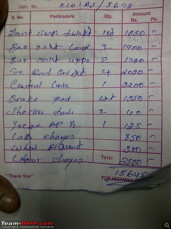

So got the second suspension overhaul at 1,14,500km. Cost me 16,900Rs inclusive of front brake pads, a rear fog lamp and a pair of mud guard ( this looks nice).
Will post the split later.

waiting for split
Was it done at T.A.S.S or outside ? Also 16900 for both front and rear ?
Just the front + brake pads + rear fog lamp (675rs) + mudflap(265rs).
I get all my service done from outside since I dnt have EW. Major services were done at TASS though for the sake of warranty/resale/claim.
Tata Safari 2.2L at 1.5 lakh kms. Reclaiming continues without extended warranty UPDATE: Now Sold !-img2013070100166.jpg
