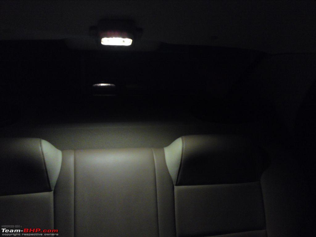

And this is the output at night. I have used a LED lamp, and it lights up very well, though biased to the center.
