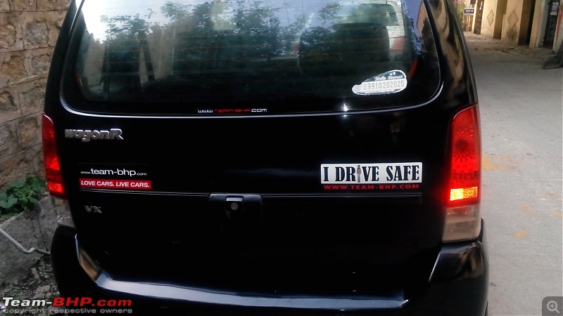

My Maruti Wagon-R F10D: 16 years, 258,000 kms, makes way for the Baleno!-img_20140621_170544.jpg
Crossed a milestone. But quite surprisingly my thoughts are more about biking these days. Recalling nostalgically various trips with my Yamaha RX 100. As of now I am completely besotted with Thunderbird 500.
