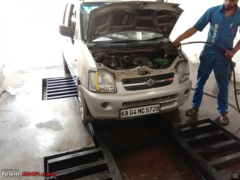

Major Service Update @ 247,000 Kms
My Maruti Wagon-R F10D: 16 years, 258,000 kms, makes way for the Baleno!-service.jpg
This one was due, for the workhorse that is still munching miles and as an obligation to update this very thread. The WagonR during the last week went for a major service and returned back with quite a lot of new wear and tear components that were due for replacement. Replacement of these will now ensure that the Tallboy is good to run without much ado at least for the next 1L km with just regular fluid changes.
This time I chose to visit an FNG that was recently inaugurated by a friend of mine who earlier was part of an ASC. The good thing was about the mechanic who worked on my car who was earlier associated with the same ASC and being a Maruti, as I waited and watched on Day 1, I noticed that he or I didn't have to bother on 'which bolt should I loosen first' situation. He knew the job well and he executed the same to perfection too!
Here are the details of the major service:
This one was a periodic service where all the fluids were replaced and apart from that the following wear and tear parts too were replaced.
