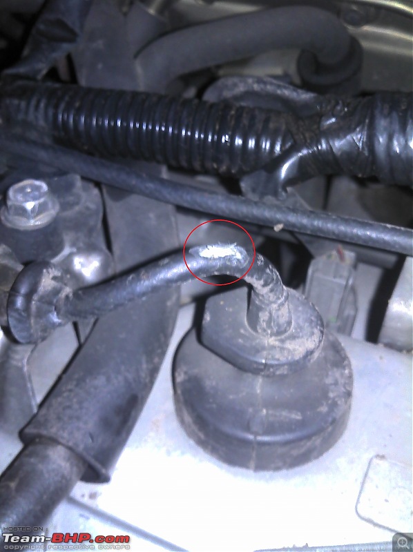

@abeerbagul: Are you sure that napthalene balls can protect against rats? I have a feeling that they don't work based on my experience, but I have to try more.
Meanwhile, I realized one wire was slightly chewed. Does it need replacement or can I just put some electrical tape around it?
See picture, which is a close up shot. In real it does not look that bad.
It's White, it's Sports and it's a Mitsubishi Cedia - 189,000 km done! Edit: Sold!-img_20140107_223208.jpg
For the timing belt, v-ribbed belt, alternator belt, etc. were changed in the fifth year in my car. So, you are right about that part.
