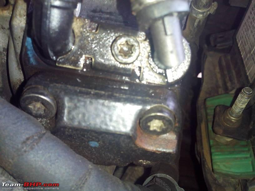

The odo now stands at 69338 and the diesel leak issue is now resolved. Was fearing some complicated issue as the leak started to increase. I had to cancel my train tickets over the festive weekend and drive down to coimbatore just to get this fixed.
Was wondering if I had to remove the pump and get it checked as that might be time consuming and probably be an expensive one too. But in the end it hardly a 15 minute job. The clip/connector had a hairline crack which caused the leak and hence we replaced the same. This part we heard is not available (was told this hardly cracks/fails) and hence had to get one from scrap and used the same.
The leak before issue was fixed

The connector held in the hand was the culprit.
