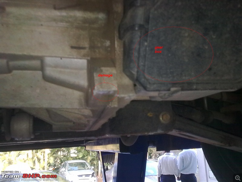

update about a new problem.
I started facing gear shift problems for 3rd and 4th gears.
It just wouldn't go into the slot easily. observed this from 2 days back.
got it checked at my dealer, and after initial trial and check, they said they need to check the gear box and it will take more that a day. They will be picking up my car tomorrow morning.
I was also told that it might be due to the underbody hit that has happened when a stone hit my underbody! attached a pic of the same.
Anybody else faced this issue with the figo? any suggestions?

About your gear slotting problem: I would suggest you begin with the linkages and cables. If your car has taken a big hit, then it is possible that something has just worked loose. Does it feel like you are stirring a spoon in a bowl of curds when shifting into 3rd and 4th? What about 4th to 5th?
Didnt quite get the comparison
My problem is that the gear lever doesnt sit into the slot properly, It takes some adjusting before I can successfully change to 3rd and 4th. Other gears seem fine. 3rd to 4th and 4th to 3rd give issues.

apparently, it was just a minor adjustment. they have adjusted the torque on some nut(?) in the gear assmebly I had pointed out in the pic and some other cable adjustment. Car was picked up from home and dropped back same day. Will be checking it out tonight and update.
