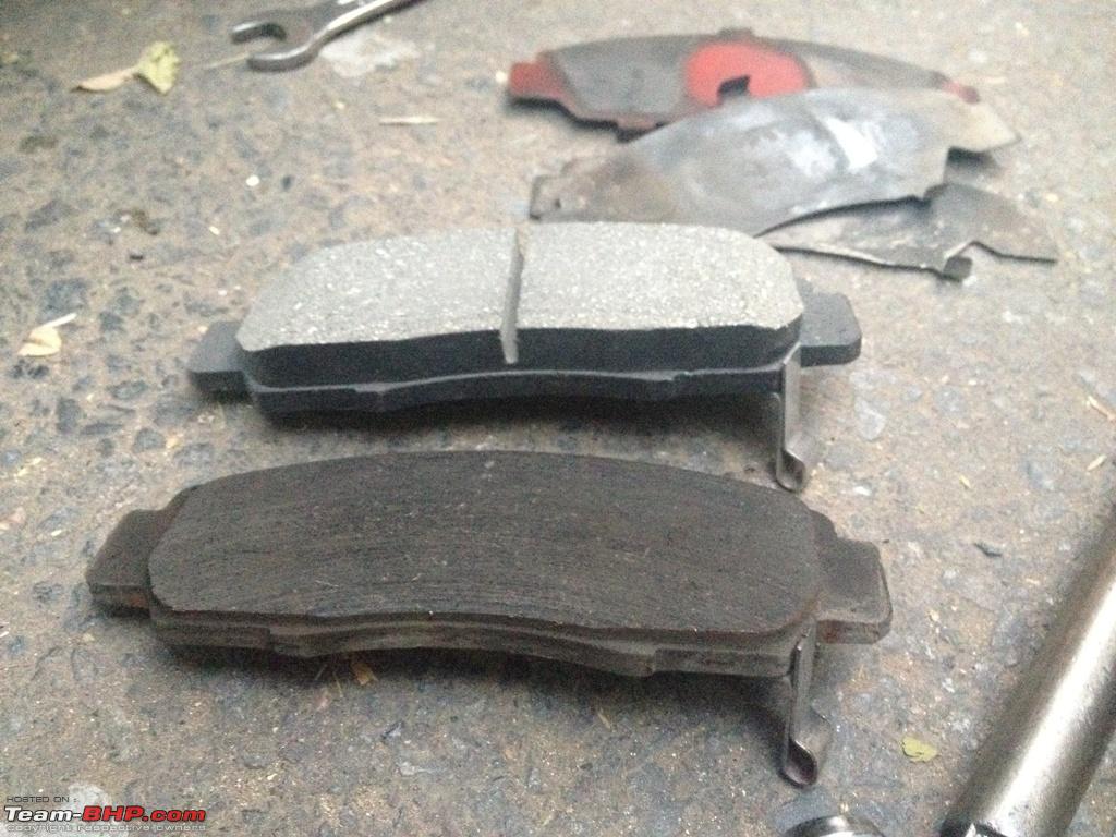

From past couple of days, I was hearing a grinding noise from left rear wheel. I had my suspicion on brake pads running out of juice and for its check up, I decided to take my car to my mechanic. Turns out I was right, the brake pad had gone bust from one side and the metal clip was grinding with brake disks. Decided to get new TRW brake pads all round.
Total expenses: INR 1250 for front pair, INR 850 for rear pair and INR 700 for labour charges = INR 2800.
Checked the disks as well, they are fine... just need facing on the lathe (will get that done soon).
The Culprit brake pad.
My Grey Shark: Honda Civic V-MT. 142,500 kms crunched. EDIT: Sold!-022.jpg
A visual comparo of new and old front brake pad (both TRW brand). Old pads ran out of life in 30,000 kms.

@ACE
By looking at the brake pads the wear on them is uneven, which means the piston inside the caliper is not moving uniformly. Please get the caliper serviced by getting the pistons cleaned and checking for wear on pistons and O-ring. If required change the caliper piston and O ring or know as Caliper rebuild kit.
you might end up with pre-mature wear of your new set of brake pads also.

Originally Posted by jatinpatel
@ACE
Thanks for the info, Jatin. Will get the calipers checked next time I am taking my car out to my machenic. BTW, this uneven wear was only noticed in left side rear wheel, pads on the rest three wheels wore out evenly.

Uneven brake pad wear in the rear of civic is very very common issue.
Get it attended to and see the difference in braking.
