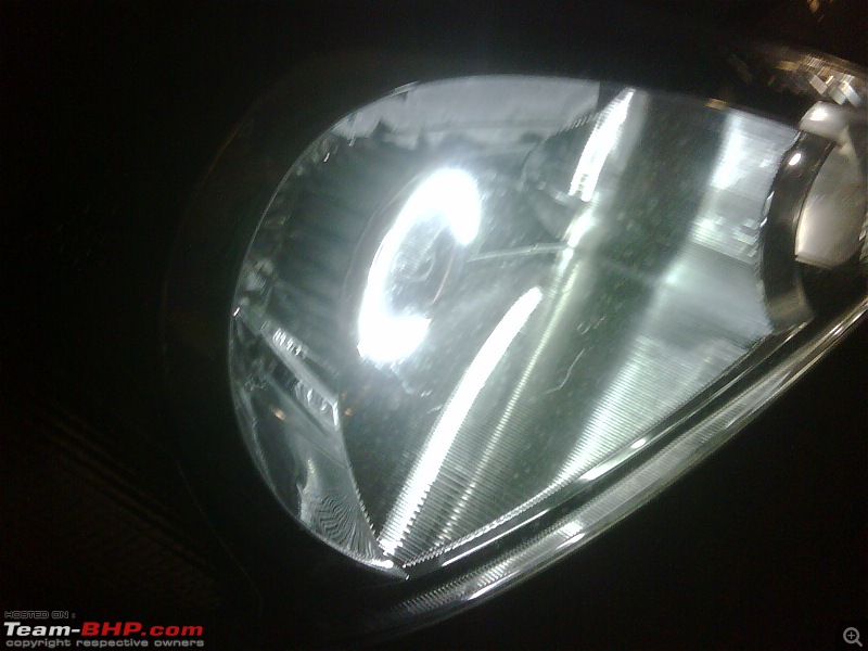

Hi Everyone,
Here are the pics. As you can see, there seems to be no difference between the low and high beams!
Could anyone be knowing a professional place where they align projector headlamps?

Nice install there nitin. As you had mentioned, you need to align the lamps. The focus isnt adjusted well. There are few places in Bangalore where they do alignment of projector headlights. Kindly visit the Auto lighting thread for details. I remember seeing the details of the place where they do these in Blore.
