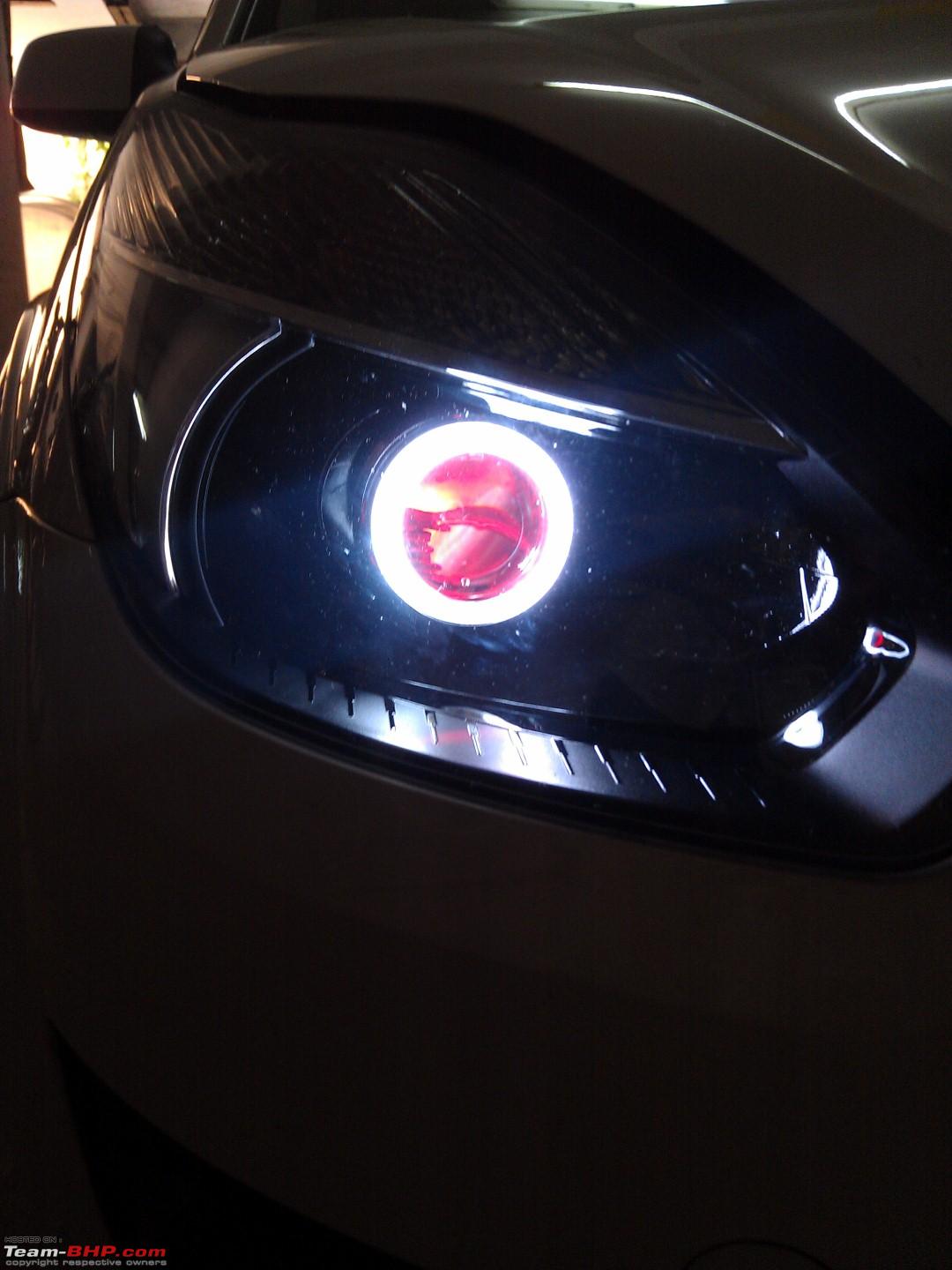

The car prior to the modification - regular headlights
Left headlight
Right headlight
Low beam
High beam
First impressions
Product
Quite bright but takes about 30 seconds to warm up to temperature. The Angel eyes with the Demon eyes are surely a show-stopper. The low beam and the high beam are a good switch over i.e. its not an incremental light up. The high beam pretty much blasts the dark road ahead with a clear ray of light. The low beams are more the enough for driving on our roads. The lights retain their levelling feature and so I kept the focus on 0 so that I don't irritate oncoming vehicles. But the ones who decided to light my car got lighted instead. (sorry, I get quite angry about cars with high-beams).
Store
Reliance Autozone, HSR layout has some good guys. Though my installer came from somewhere else, the store guys were quire professional and helped me through the process. They just didn't leave the installer to do his job but kept a close eye on the proceedings which I liked. The slight negatives - the minimal parking area in front of store. They have a basement parking where most of the work gets done. But sometimes, it can get crowded in there. Yesterday, when they were working on mine, we had a Ford Ikon, a Ford Fiesta, a Quanto and a City which stopped by for nitrogen. So, its a tight squeeze. Especially, weekends would be busy, I assume. Would go there again.
Installation
The guy, Ijaz, is pretty good. He did the installation patiently and didn't hurry. Even when sometimes I asked him if something was enough (like the paint drying), he'd wait a bit more to make sure everything was sorted. And he keeps checking with you to make sure you're happy with how its shaping up. So, that's a definite plus.
Cost
Genome Kit - 15k
Spray painting headlights - 2.5k (thought this was way too steep)
If you want to do this yourself or buy directly from Genome, the price is 12.5k for the same and they'll send an installer to your place for the work. That's my understanding. I didn't want to take the risk of some random guy doing the work and then disappearing and hence went through Reliance Autozone. 1 year complete warranty is provided for the product including bulbs.
Overall, very happy with the product, the installation and the service. Hope this helps me see better at night. Thanks to Parthasarathig for the valuable help and pointers. And keeping my fingers crossed that the Ford service guys won't raise a stink regarding warranty when I visit next.

So finally you took the plunge and got yourself these projectors. The Reliance was the better option for the money and headache free also.
Do keep updating this thread regularly so we know how its shaping up for you. Also can you post pictures in the dark, taken from inside your car with the headlamp on? Want to see how good the throw of the light is.
The warm up time is normal and its even there in the JC road one, but that only occurs during the first light up.
All in all, this is looking very good on the figo. Can you tell which brand of HID bulbs have been placed in the projectors?

The demon eyes looks awesome. So do you say the focus on low beam is brighter now ?
Do post pic of front portion of car with both demon eyes. Also picture of the car in broad day light. Just qurious how the blackned headlamps look with headlamp switched off.

Angel eyes look great. Can you post a picture of beam throw if possible? Like how is the spread on road.

Nice mod, I understand the workmanship is spot on however, were the headlight assembly sealed properly. Please do report if you observe any dust collection or after a pressure wash if you observe condensation inside the headlamps.
Also please post the low beam & high beam both from inside the car as well as from a distance outside the car (to check on glare)
