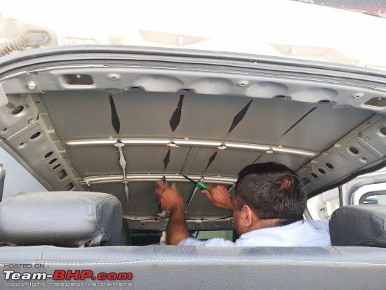

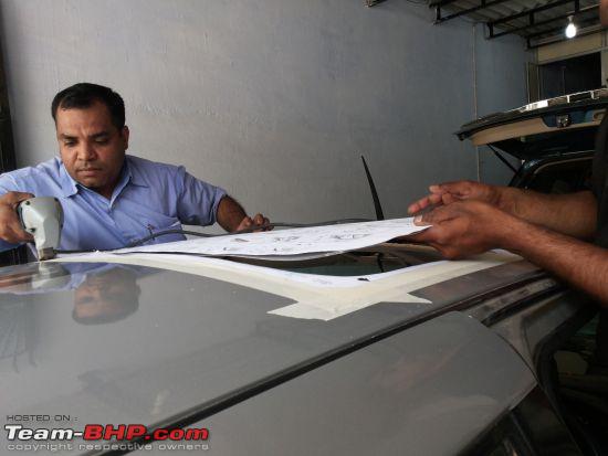

After a major fallout with Motherson india years ago Webasto had shut its operations in india, Finally Webasto is back in india and also in Delhi.
After years of waiting and search for right company and support. if finally get a sunroof in my car.
Webasto being an OEM supplier to almost all automakers, i had my trust in it. My apprehension was not the product but the installation, Procurement of the sunroof is easy but installation needs professional hands. I had seen many cases where people ended up buying Chinese sunroofs to save a buck and then installation by people who don't know what they are doing ended up as a disaster.
After finding a webasto dealer in Delhi , I paid him a visit. Long discussions happened and finally i decided to have one. I selected the Holandia deluxe LARGE 300 Model. Tough i wanted to go for the INBUILT 730 Model but that wasn't available and i was impatient to wait. All model have standard features its just the size and opening area changes from model to model.
Features like ANTI-PINCH , AUTO-CLOSE when ignition is switched off are standard.
Anyways knowing i was very particular about the installation, I was made to meet the webasto trained technicians who talked me thru the process, showed me the tools, i got to know webasto used sparkfree cutters and grinders and man they do a neat job.Proper marking sheets are provided that helps them to fit the roof properly.
The entire job sounds so tedious but they fit a roof with in 2hours if no alternation are required to the car.
I most of the cars they fit the cars with out even removing the headliner. Its that precise. In my case because i opted for a non-recommended model, Headliner had to be removed and alternation to a beam had to be made. This raised some question in my mind about the strength of the roof. So i was shown that the chassis of the sunroof will come there to strengthen that portion.
Webasto's SOP also included using an anti-rust solution on the edges where the cut in the roof is made as a precaution.
Rest installation is been shown in the pictures.
Im loving it
