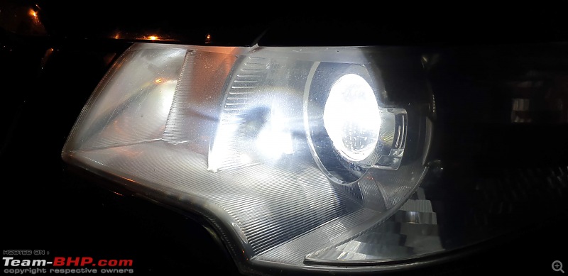

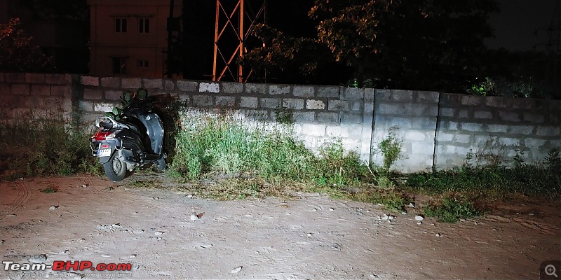

Hello there!
After getting sick and tired of OEM Philips D1S 4300K candles in the bi-xenon projectors, I decided to go for some low-cost aftermarket 6000k HIDs. But that didn't help much as well. Decided to go the LED route but unable to remove ballast (situated below headlights) and the plan was put on hold.
In about Oct '19, saw some plug and play stuff on Aliexpress which could plug directly into the ballast output. Hence, it was decided then and there that I must try this 6500K 4000Lm 35w contraption:
https://aliexpi.com/sB5N
Not as good as some on the thread by in my eyes, the results are fantastic (for 10 year old faded and cloudy headlight plastic). Not much when in well-lit places, but in darkness, they work really well. Consequentially, upgraded reflector high beams to H3 LEDs as well
Here is a video of my driving back home from work:
Some photos as well:
