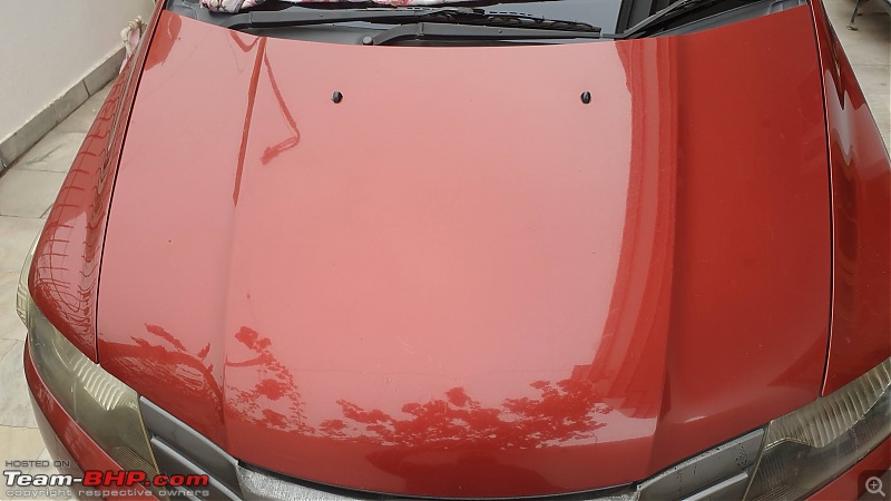

Test subject
-Dad's Honda City(2008) Maroon color
-Vehicle has been sparingly maintained(No detailing whatsoever)

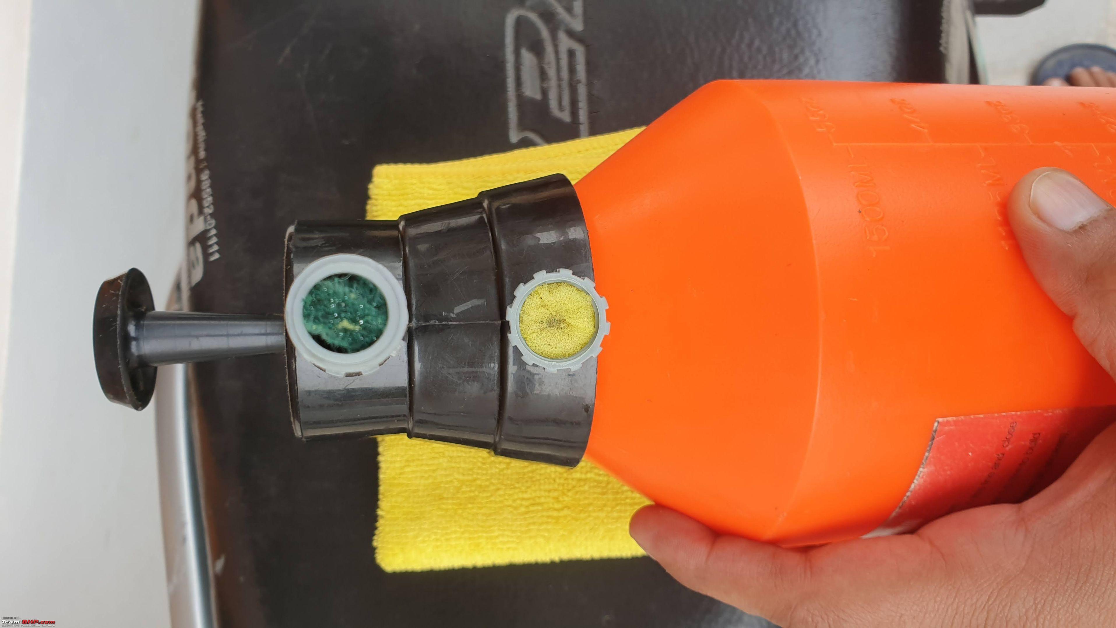

1.Removed the metal sprayer nozzle from the existing sprayer.
2.Applied some tape on the sparyer nose followed by fitting of the foam sprayer nozzle which came with the packaging.
PLEASE NOTE -Once you remove the metal sprayer nozle you cannot fit it back as in the fit wont be perfect and might leak.
In my case the nozzle was anyways damaged so i did not try to put it back.

-Based upon my testing the foam generated is acceptable in the sense it will drip down and carry all the muck.
-The amount of foam generated is dependent on the amount of pumping.As in with maximum pressure the viscosity of the foam is less but acceptable than if you pump it around 75% which generates thicker foam.
-In my opinion the amount of effort is not that big of deal considering the quality of the foam you get in either case.

I am using the universal sprayer for this.So what I have done is I have bought an additional sprayer nozzle (The handle part which contains the pump , handle & nozzle) .When i want to use the regular sprayer i use the regular head with metal nozzle and while using the foam I use the one in the pictures.This process i followed is more effective in coverage what i have observed and saves time.
