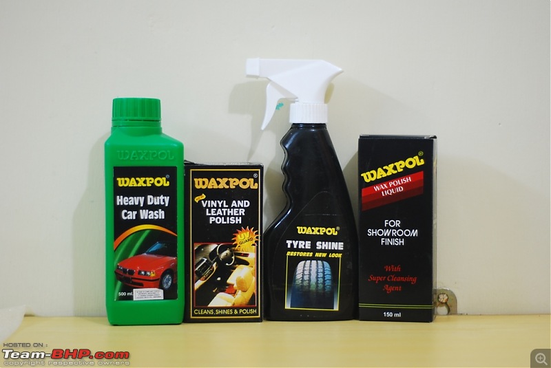

waxpol range
got a range of waxpol car care product from spencers last weekend - hope they are not fake (all the stuff is made in Kolkata itself)
Huge Fake Car Polish/Wax market in India-dsc_3978.jpg
Used the Tire shine,vinyl and leather polish and the car wash - all of them work great. Yet to use the wax.

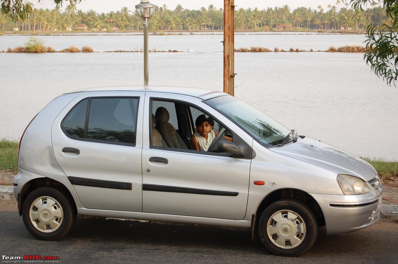

Originally Posted by maglev View Post
Can you post pictures of your car, they would be really really helpful.
Here are the pictures of my cars but I do not know how to edit out the number plates likes others do it here since I do not have any photo editing software. I am good at modifying the operating system for speed but nothing else as far as software is concerned but thats way off topic. The XP operating system on my computer is just 132mb and have sent it to Microsoft for their approval. If some moderator could help out here in blanking the number plates. Thank You. The PalioGTX was bought on 23 July 2003 and the Junkindica on 31 May 2000.
The GTX has been booked by one Mr Gautham from Bangalore and will be sold off in Novemebr 3rd week and the Junkindica will be with me for many more years to come. Will take delivery of the Cruze in January 1st week. Not decided about the colour as yet. Wax the plastics as you normally would any painted surface. The only thing to be careful about is that the cloth with which you are going to finally buff it should be clean and dry.
