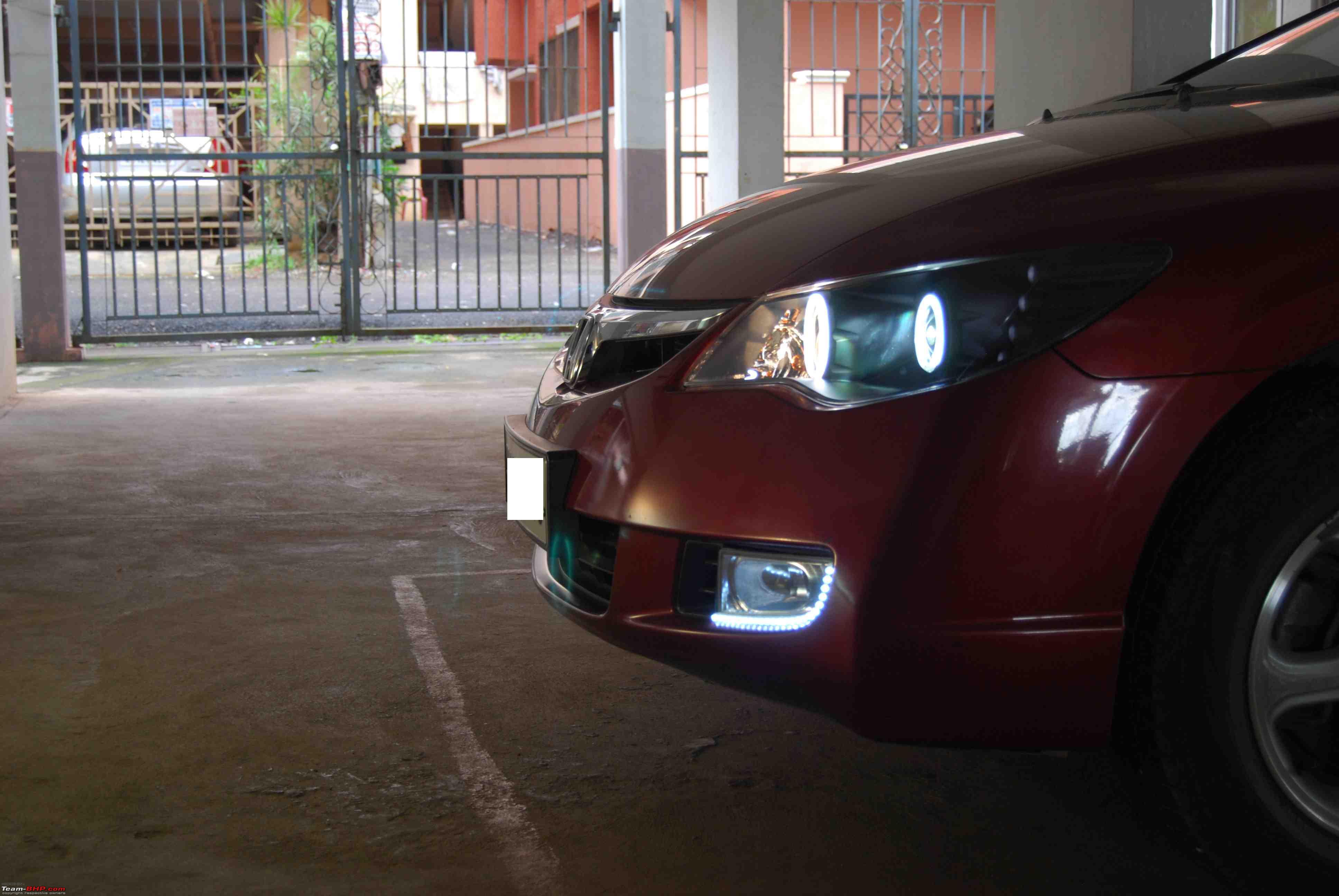

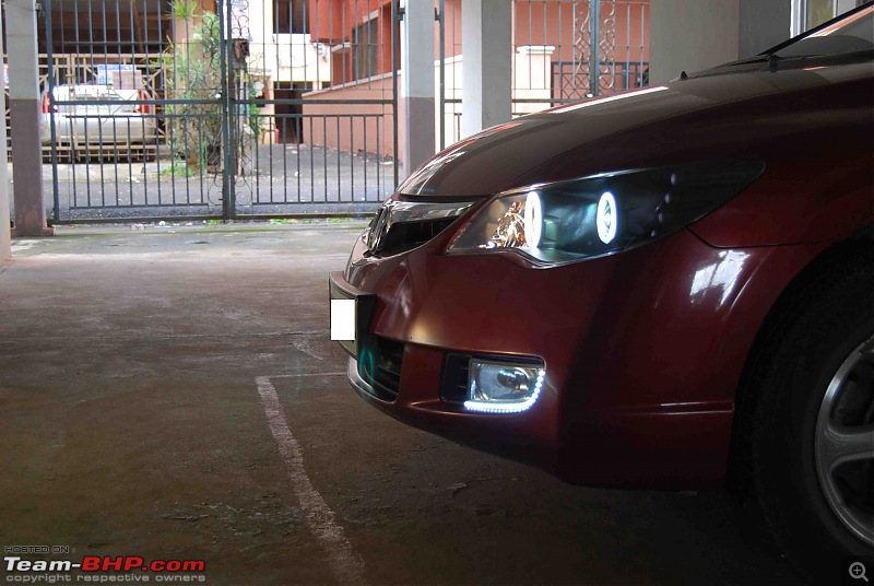

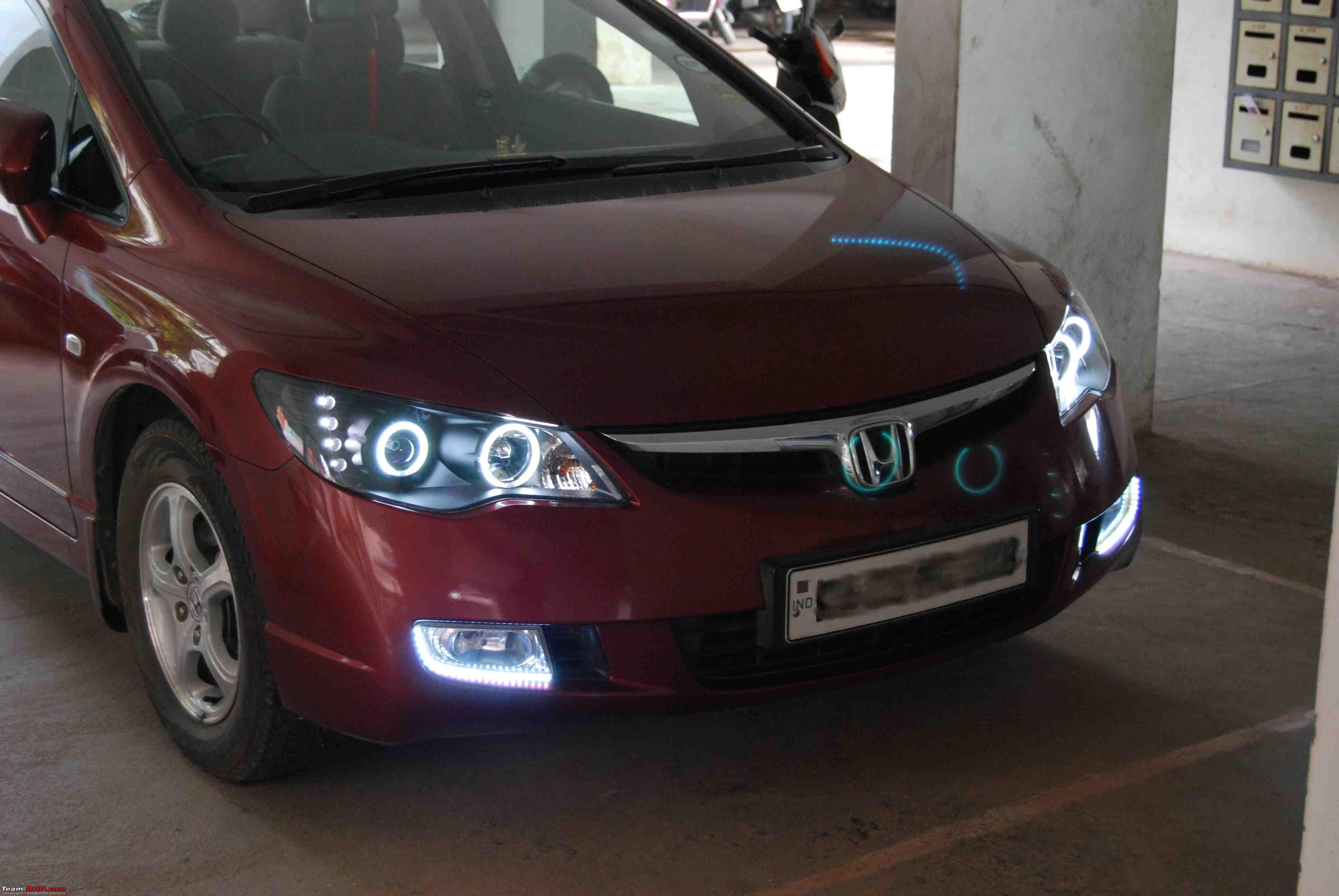

Here are some snaps, sorry for the delay
Hey dinu, excellent pics. Now how about some pics with the lights switched ON showing the low and high beams?
