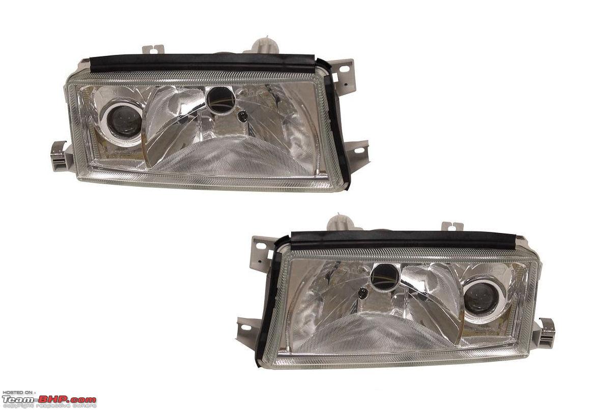

In some time i have to replace the headlights as well. can i install the oem projector headlights instead of the h4 ones in octavia.
I can manage the wiring but will the ECU or car interface create a problem, particularly the xenon range adjustment through vagcom?
will it be a plug and play since cars were being sold with both type of headlight options by skoda

I know nothing about Skoda electricals but in Captiva/Cruze and many BMW models, you need special CanBus controlled HID ballasts. Else the system will report HL failure. I've heard about bypass modules but have no experience in using them.

If i get the complete set with cab bus controlled ballast, will it interface with my existing ecu/car which is a 2004 model petrol. Does anybody have an idea of the pricing.
somebody bought it for 18k without any masala in it.
I am already having h3 8k hid in the fogs.other option is to get the older type and a projector or put in a 90/100 and discard the bosch h4.
which of the three gives best highway lighting?
