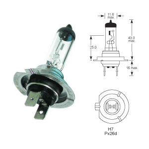

Both are Head light bulbs, both are used for headlight, foglight and driving light applications. H1's and H7's have a different filiment lengths, so will create different light patterns in different HL housings. Since they are entirely different its not interchangable, and HL housings are designed according to the mounting bases and the filiment length and orientation which plays a major role in beam spreads. H1 is considered to be high beam universally and most of the projectors as well.
Take a look on these
H1 Bulb:
H7 Bulb:

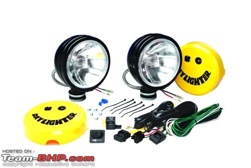

Hi - Does anyone here use KC Daylighters/Hilites? -Any observations on them?
I am tossing up between driving lights and long range pencil beams (130W).
Any feedback on the same would be appreciated.
KMT is offline
Old 21st February 2011, 11:26   #4752
headers's Avatar
Location: Greater Chennai
Posts: 4,667
Thanked: 551 Times
Personally, I have tried the long range pencil beams but found them inadequate for road use, especially in todays roads. [my grandfathers Rover 14 had it and I was gifted the same for a fit on my GYPSY, decided against it after the use i put the gypsy to, did not want to break the glass of the original LUCAS unit]
I'd go for driving lights instead of pencil beams!

How much do these KC's cost and are they available in India easily?
It cost around 10grands for a pair incl taxes.
Auto Lighting thread : Post all queries about automobile lighting here-kc_hilites_634_daylighter_6_in_black_130w_driving_beam_off_road_light_system_pair.jpg
You can order it through 20north.com
KC HiLiTES 233 Daylighter 6-Inch 100w Long Range Off Road Light System (Pair, Black) < Automotive Parts < Car Electronics < Electronics : Misc. - Shop in the US from India @ 20North
