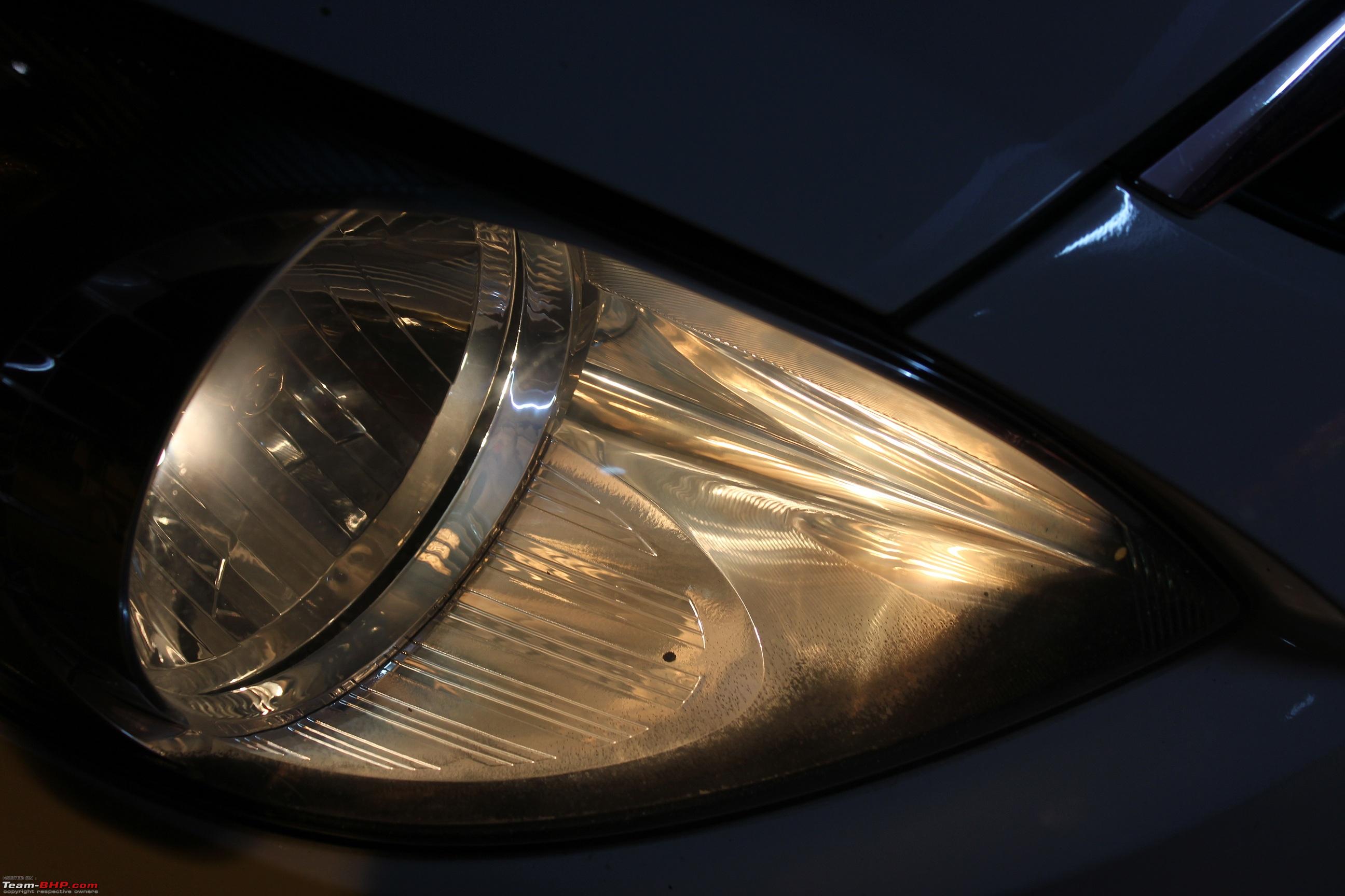

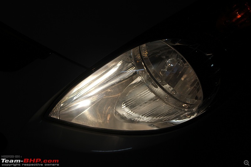

Wanted to share this with you all. Finally changed the old yellow light to white light with Philips Essential Vision H4 100/90W for headlamps, Philips Blue Vision W5W 4000K 5W for parking light & rear number plate and Philips Blue Vision HB4 9006 4000K 55W for fog lamps.
All done by myself D.i.Y. No problems or bulb out error. Now the car gets more attention on road and I'm loving it.
Do have a look and let me know your thoughts.
The Transformation from yellow light to white light.
Hope you all like it.
Another question to Automotive Lighting experts as I have changed the fog lamps from 51W to 55W will it cause any problems with increase of 4W?

Originally Posted by el lobo 6061 View Post
.. I have changed the fog lamps from 51W to 55W will it cause any problems with increase of 4W?
51W is non-standard. Are you sure you had 51W fog lamps ? Pls check again.
Yeah just checked it's 12V 51W. Will the extra 4W cause any heating issues.?
51w is on a higher side for fog lamp.it will be almost as bright as the head lamp. 4 watts won't affect the wiring. No problem

My Civic specifies 55W, so no big deal. Within manufacturing tolerances 51 and 55 are the same.
The stock fog lamps of Vento are Sylvania HB4 9006 51W. As I changed over to Philips Blue Vision 4000K 55W it is quite bright. The casing gets quite hot, but no problems as yet and hope it stays that way.
