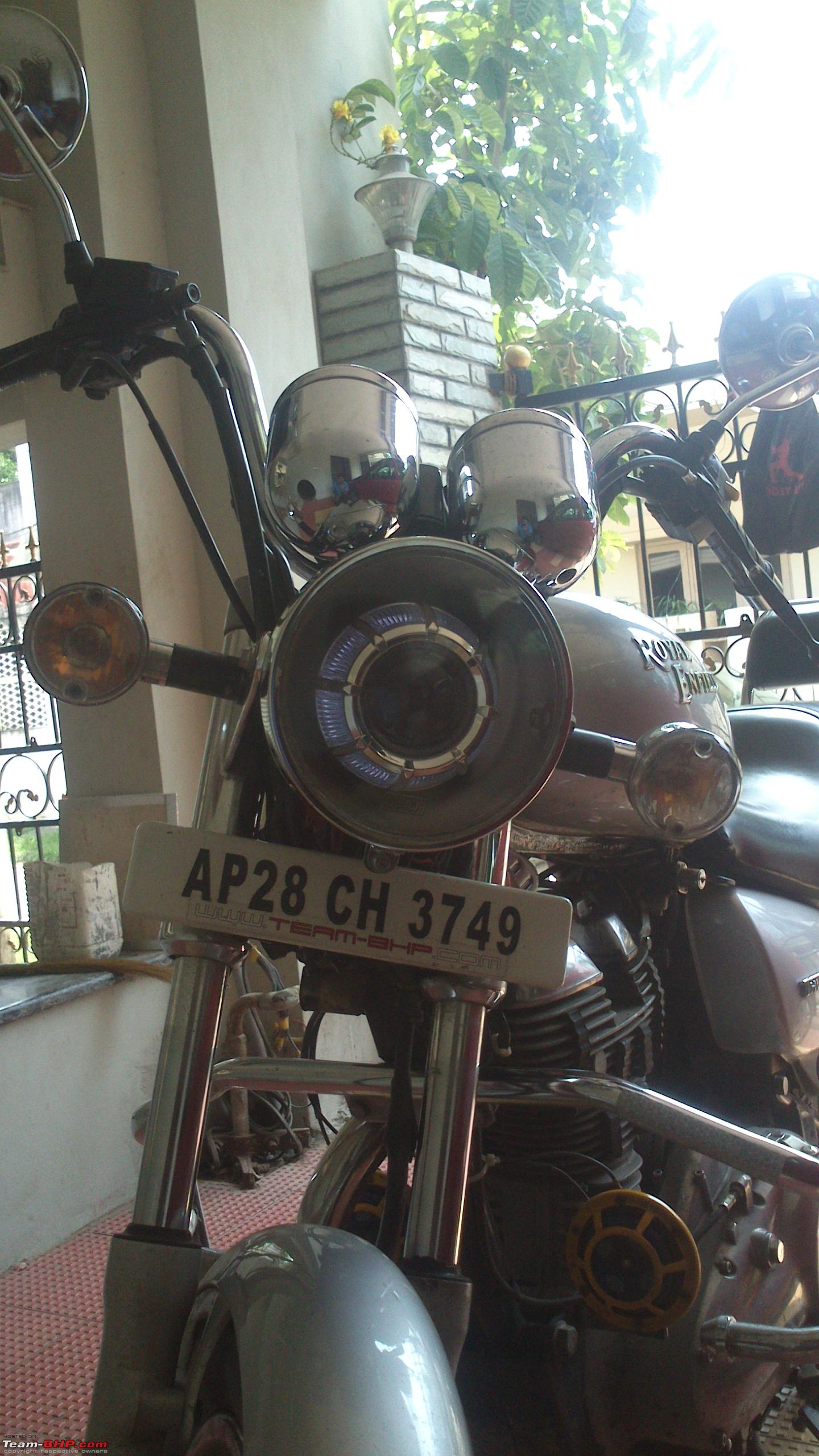

Finally, at long last i was able to fit projector and hid to my tbts. Got these from RDMotovil, set me back by close to 8k. Beam throw has good reach and spread without noticeable hotspot. I think in terms of hotspot, it compares favourably to morimoto mini which i was considering (my knowledge is only from 'beam' pics of the morimoto!) Unfortunately, i had to settle for bulb temperature of 6000k and 35w ballast. On hitting the road, i found out that having a hotspot is better when faced against blinding high beams from oncoming traffic Definitely an upgrade from my 60w bulb, but considering that the beam pattern is very focussed for the oem reflector i expected more from the HID. I'll try to exchange the ballast for a 35w one, that should probably do the trick.
Edit: I forgot to mention the make and model of the projector. Its an AES Q5. I have no prior experience with these, but the ballast which came with the kit was super small and 'seemed to be' of reasonably good quality.

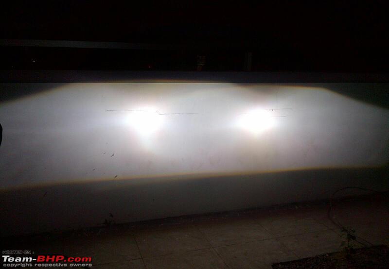

When we had talked on phone I realised that your problem was similar to mine ie.:-
1. High beam does not illuminate the near road & the side margins are in the dark. Keeping the beam on low prevents one from seeing the hazards in the distance (particularly potholes) which results in urgent braking.
2. In my case the problem is more acute on highways where there is constant oncoming traffic- because i am not used to night driving. (Hell for the last 1.5 yrs my driving has reduced so much that we now go on compulsory 50 kms jaunts just to keep the battery charged.)
3. Did not want to spend much.
4. When I am on 2 lane roads, I always switch to low, as a matter of courtesy, when there is an oncoming two wheeler. In my recent South trip (before fitting Projectors)I was doing a 10pm dash from Yellapur to Hubli on a 2 lane highway. Could manage 100+ on empty stretches & dropped to 70-80 when an oncoming 2-wheeler was encountered. I found it much more difficult driving at night on the Satara-Pune highway (4lane) or the Pune-Mumbai Expressway.
Now why I recommend you to fit projectors in High is a follows:-
a). During High beam your HID-Projector will give good long distance illumination and fairly useful short distance light. This is based on my experience with the Fusion after the change. i still have to do final adjustments.
b) If you can rig the wiring such that Original Low beam remains on during High beam setting you will get more that enough light. Possibly you may manage to drive on Low beam alone with the light from projectors(in low beam) & Original Low beam.
c) I had taken a night test drive, on rural roads & 4 Lane Highways immediately after fitting the projectors & am more than satisfied. i am now able to see much farther on High Beam & there is enough side & near illumination. In most cases Low Beam was sufficient.
And of course One cannot get ideal lighting in all situations. I have a simple remedy -drop speed until things improve!!.

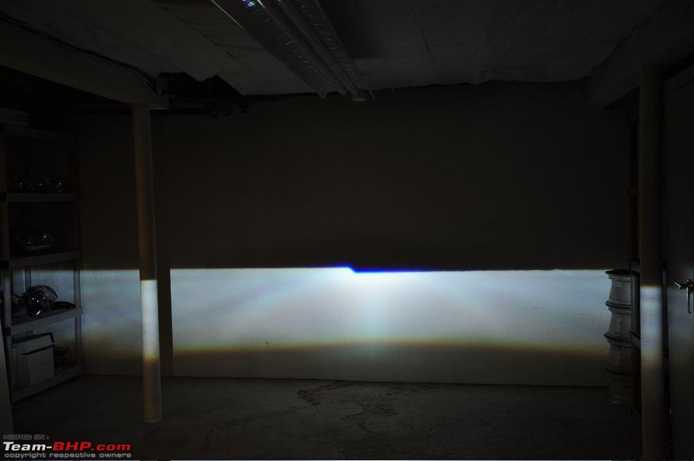

I had fitted the Silver series. Joy told me Gold gives better performance. I am inserting below some points he made on this:-
"One the visible differentiating factors between projectors are also their difference in cut-off impression, the beam pattern, the colour fringes, squirrel finders & foreground lighting. Fxrs output differs from gold, to silver to the base model. Attaching a few pics. The ‘suitable shape’ what u referring to are the ‘squirrel finders’, which although fills up the black spot but also increases the glare. The trick is to converge the L&H beams marginally so that when on read, it vitually negates the effect of black spot. Silver doesn’t have provision for squirrel finders. Gold have a different shield shape altogether. FXRs don’t have these issues, however it’s a compromise with foreground lighting."
Also some comparison photos of beams that he sent me.
First is Silver Series-(Low & then High)

Auto Lighting thread : Post all queries about automobile lighting here-gold.jpg
Auto Lighting thread : Post all queries about automobile lighting here-gold-2.jpg

In the end you will have to make some compromises. To my mind dropping your speed from 80 to 60kmph in tricky situations will solve most issues. it won't affect you overall travel time much.
If you want you can drop down to Pune & we can go for a night ride. Let me know in advance.
