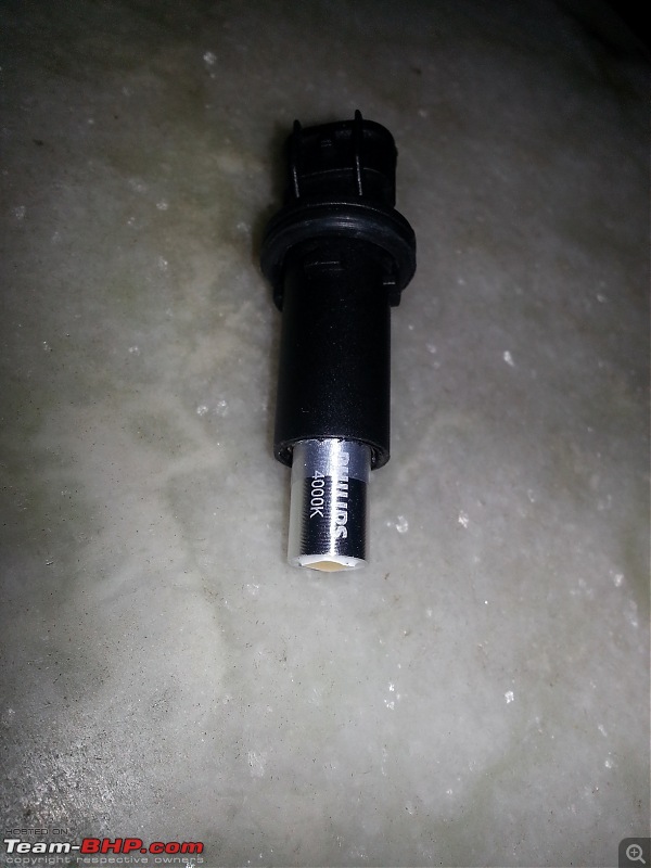

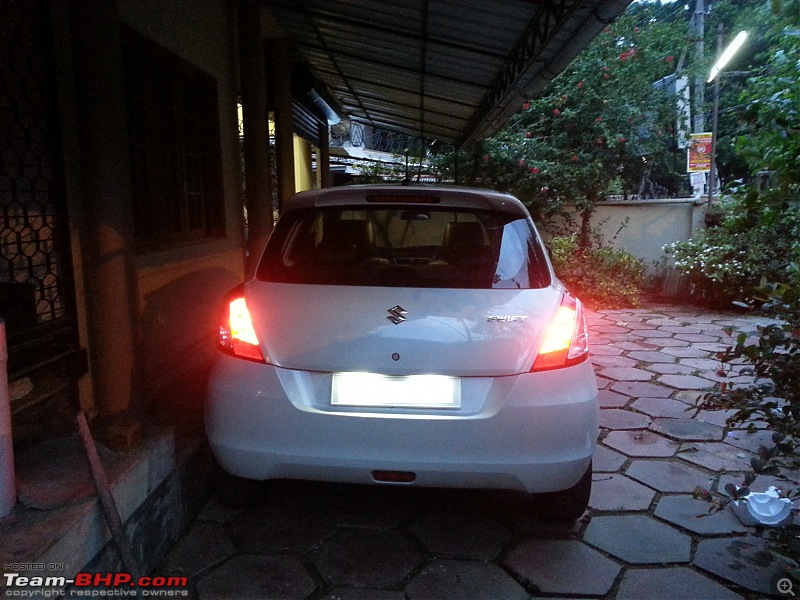

Retrofit LED bulb upgrade
Done:
Philips P21/5 LED for Brake/Tail lamp
Philips 30mm festoon 4000k for interior light (Replaced no name chinese LED with this)
Philips W5W 4000k for park light
Next upgrade:
Philips Amber LED for turn signal indicators
Philips white LED for reverse lamps
Auto Lighting thread : Post all queries about automobile lighting here-20140610_140627.jpg
Auto Lighting thread : Post all queries about automobile lighting here-20140610_164111.jpg
Auto Lighting thread : Post all queries about automobile lighting here-20140610_170559.jpg
Auto Lighting thread : Post all queries about automobile lighting here-20140610_170639.jpg
Auto Lighting thread : Post all queries about automobile lighting here-20140610_171858.jpg
Auto Lighting thread : Post all queries about automobile lighting here-20140610_175424.jpg
The LED placement on the Philips P21/5 retrofit bulb is at the same position as the filament of the incandescent lamp. So the pattern in the tail lamp lights up as intended (in the swift) and looks OEM.
1st pic - LED on LH tail lamp, Incandescent on RH tail lamp
2nd pic - LED on both tail lamps
3rd pic - LED on both lamps - Brake light mode (need to change the third brake light to LED)
4th pic - No name china LED (3 festoon units soldered together)
5th pic - No name china LED illumination
6th pic - Philips 4000K festoon interior illumination (warmer colour)
7th pic - Philips 4000K W5W park lamps
There are no exposure settings in my cell phone camera, so can't say these pics look the same like how they are in reality. But one thing is for sure, these LEDs are damn much brighter than stock, even the tail lamps!
