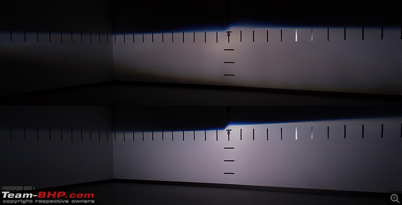

Here a picture recently posted by TRS on their FB page comparing the generic china Mini H1 projector with Morimoto Mini H1. The difference is clearly visible. FYI top one is generic and bottom one is Morimoto.
Image Source:- TRS FB Page
Auto Lighting thread : Post all queries about automobile lighting here-10499466_10152169707216881_6346069718368505196_o.jpg
